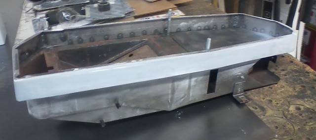

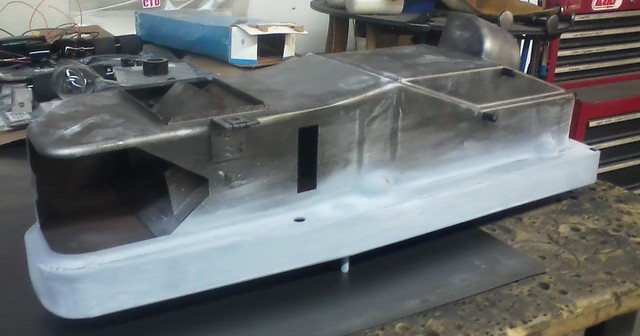

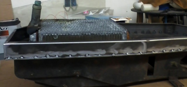

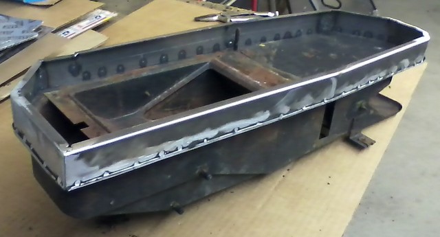

The outside heater box needed to be cut down quite a bit to clear the BBC. The problem with this is the heater core that mounts to the inner heater box, sticks out past the firewall 2 inches.
What I came up with is to move the inner heater box toward the inside of the car, so it will bring the core toward the inside of the car.
This was done by fabbing 18 gauge strips with a 90 degree lip and adding them to the inside box.

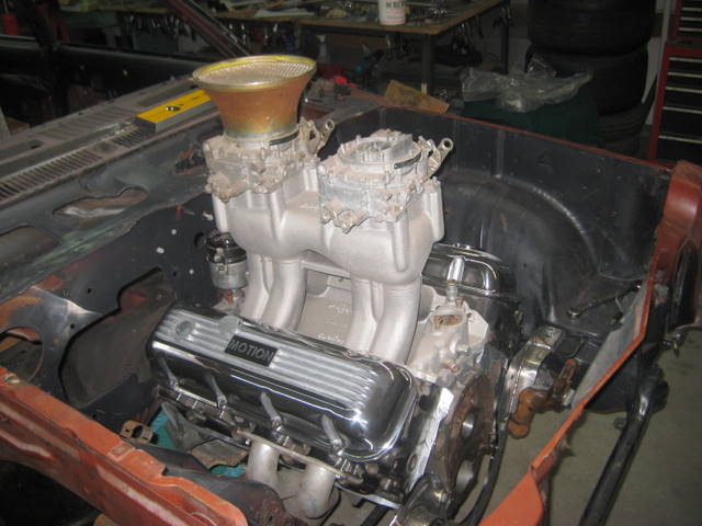

Worked on the car a little and fitted the Motion headers. I'm going to have to do a little tweaking, but overall they fit better than the Hooker headers. They can be installed one tube at a time with the engine bolted in place. This will be nice when it comes time for final assembly. No more having to hold the headers in place while lowering the engine in.
The steering shaft will run through the headers, so there will be no need for three steering joints and running it on the inner wheel house.
Also, I should point out that the Motion headers do not require the two rear tubes on the pass. side to run out through the wheel house, so turning radius will not be affected.
BTW, a while back the question was asked about these being real Motion headers. Looking in my V8 Vega book that Schorr wrote, there is a picture of the driver side header, not installed on the car. It's an exact match to what I have.

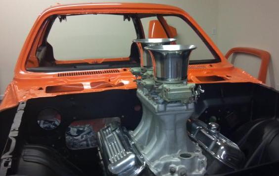

Default Re: Day 2 Vega
Thanks. It's about ready to paint.
Your work is fantastic but please don't use those cheesy valve covers on this very cool build! I have an original set of Motion valve covers with emblems if you're interested.

Thanked 2 Times in 2 Posts
Thanks.
Those covers went on a friends car, I just set them on there for the picture.
I have a set of CP covers that I am going to install a set of the repop emblems on. But I would love to have an original set if I can swing it. Can you post some pictures?

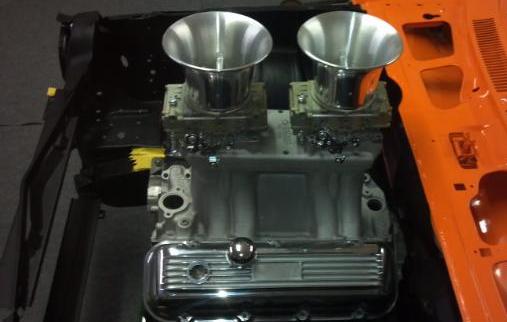

It's not the critic that counts, not the man who points out how the strong man stumbled or whether the doer of deeds could have done them better...

I LOVE those velocity stacks. Do they have the air cleaner built in?
John 10:30
Old 12-21-2012, 11:31 PM
Hemicolt Hemicolt is offline
Join Date: Nov 2011
Location: East Tennessee
Posts: 966
<div class="ubbcode-block"><div class="ubbcode-header">Originally Posted By: markinnaples</div><div class="ubbcode-body">I LOVE those velocity stacks. Do they have the air cleaner built in? </div></div>
The stacks are the ones that Mr. Gasket still offers. No air cleaners.
