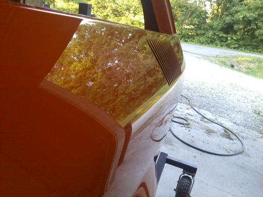

Hit the car with 3000 wet paper on the d.a. sander. Check out the reflection of the trees across the road.

Looks good, don't go overboard with the DA. It will give small flutters/waves. Best to wet block up to the highest possible grit and quickly DA without the soft interface pad (except in real curvey areas)

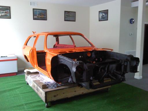

Got the car down to my other shop. Going to let it sit for a while and then start putting it together.

looks awesome!! and sweet shop! great job can't wait to see it finished.

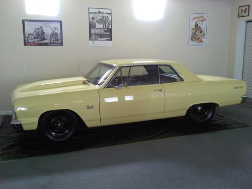

Tracy,
Saw this last night....very nice.

<div class="ubbcode-block"><div class="ubbcode-header">Originally Posted By: Postsedan</div><div class="ubbcode-body">Tracy,
Dan </div></div>
I would have kept the stock hood and leave them wondering what just hit'm

That's a very clean install of the LS engine. I would like the car better if it wasn't tubbed.
