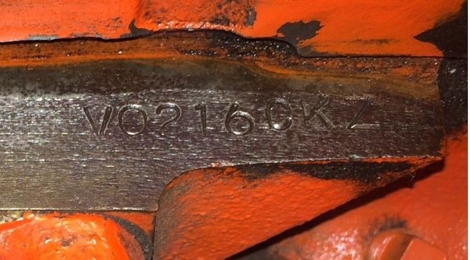

CTV suffix code wow, a ZR1 vert hiding in plain site. Jeez.

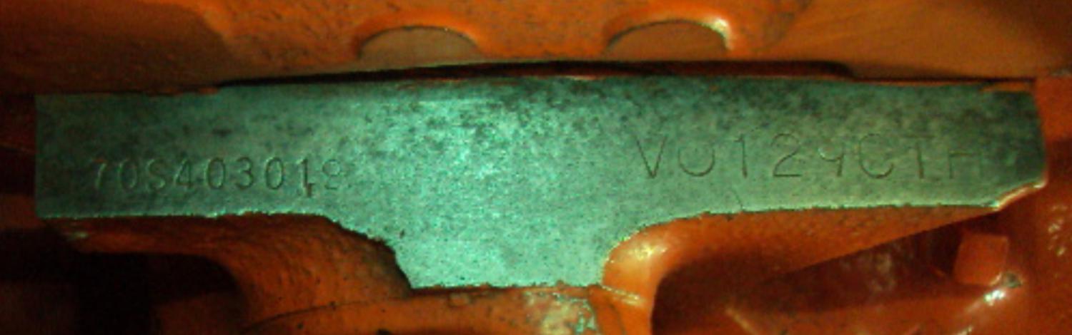

Here’s the stamp pad of a car built 6 units later. This serial number stamping is what I would consider typical for 1970 production.
