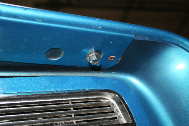

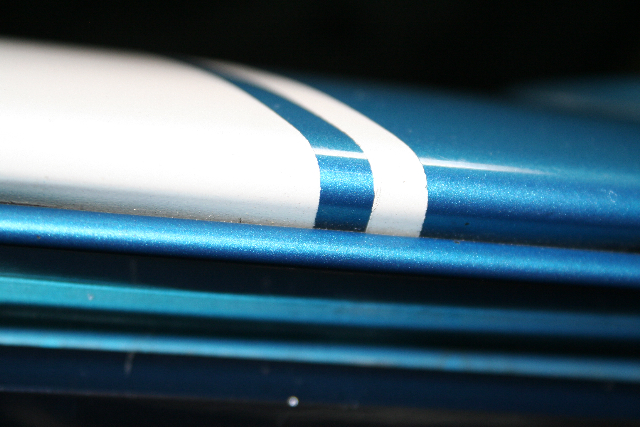

Here are some pics of the header front/grille stripe, definitely striped without the grille in place. The other pic shows the grille reinforcement against the grille. The reinforcement and headlight doors match the header paint and were painted separately. The grille has very little paint on the top and is a slightly different shade.

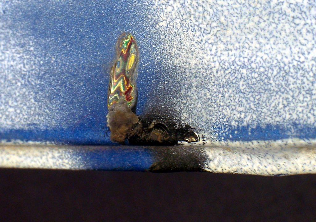

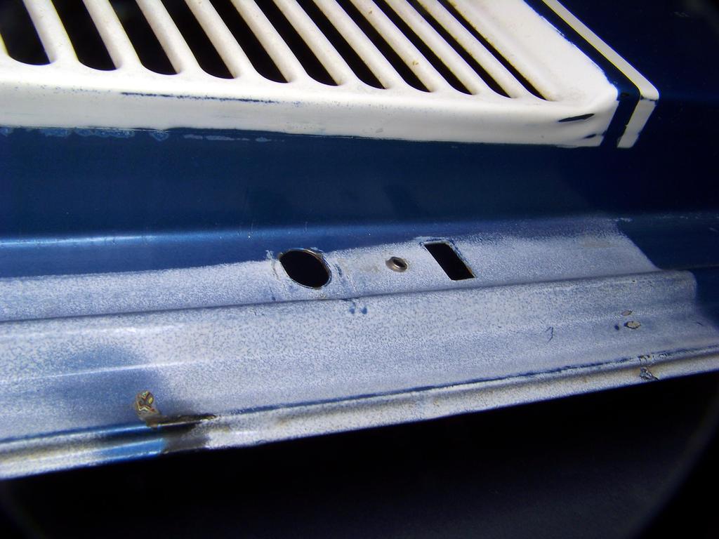

How bout this factory tape job on the 51k mile Lemans Blue one I am currently restoring...
Check out the lower left hand side of the photo... anyone remember John saying the cowl grilles were hung by hooks? think they used new ones everytime? Well when they reused the hooks paint built up and eventually could remain on one of the panels...
Lets see which colors chipped off...hmmm garnet red, rally green, daytona yellow, cortez silver...

Wow very nice paint snot from the hooks you got there. Psychedelic too. [img]<<GRAEMLIN_URL>>/smile.gif[/img]

Great shot! I know that at the St. Louis assembly plant we would take the racks out in batches and burn them off occassionally. Then whack them with a hammer &amp; brush off the excess. Really high tech!

Always the snot run to give the car a lil extra character. You gotta leave it on there somehow and don't remove it.

I bought another wiper grille to paint with the car and kept the one above to go along with the car for posterity.
