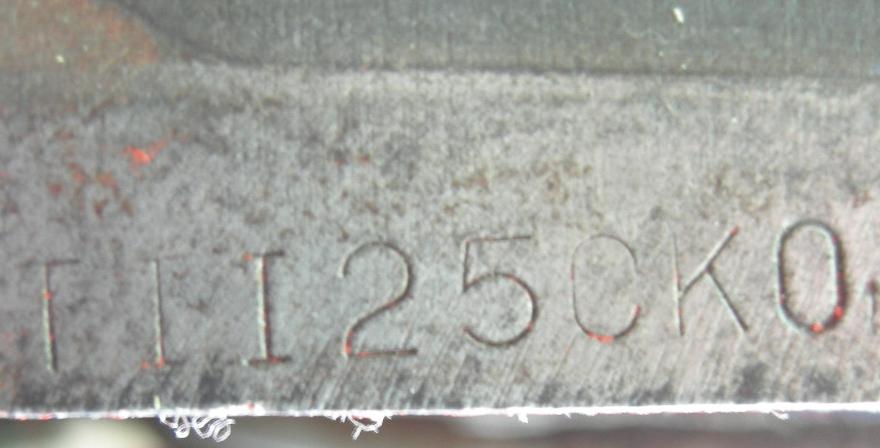

Joey, here is a pic of a 70 Nova 375hp/396 block you can se the broach marks pretty well. Were these engines stamped before or after the installation of the heads? m
Mark, that date is the same as my 70 black 4psd car....11/25/69 CKO I guess the Buffalo boys were busy that day..
