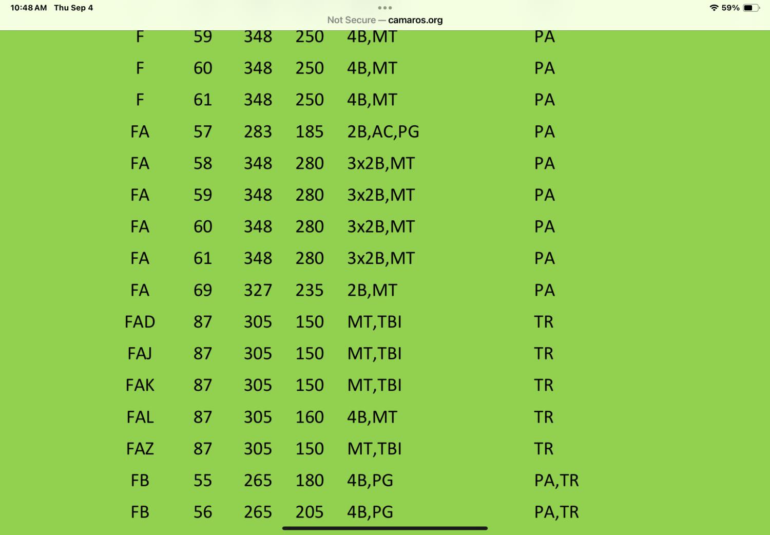

the original protecto plate that I have has the code F0329FA. In researching this that code on the plate represents
F- Flint Michigan
0329 - March 29 1966 - engine assembly date
FA - 427 CID / 425 HP - L72 engine with manual transmission (M21)

ID is the 427-425hp suffix code for a '66 full size Chevrolet.
Yes, that. Not FA

Looks like you may need new research material, Ken. And unfortunately, reproduction ProtectoPlates are available from several sources....they can be made to say whatever the buyer wants.

Not sure where you’re getting your information as to the “FA” code but see attached from the Lime Book
