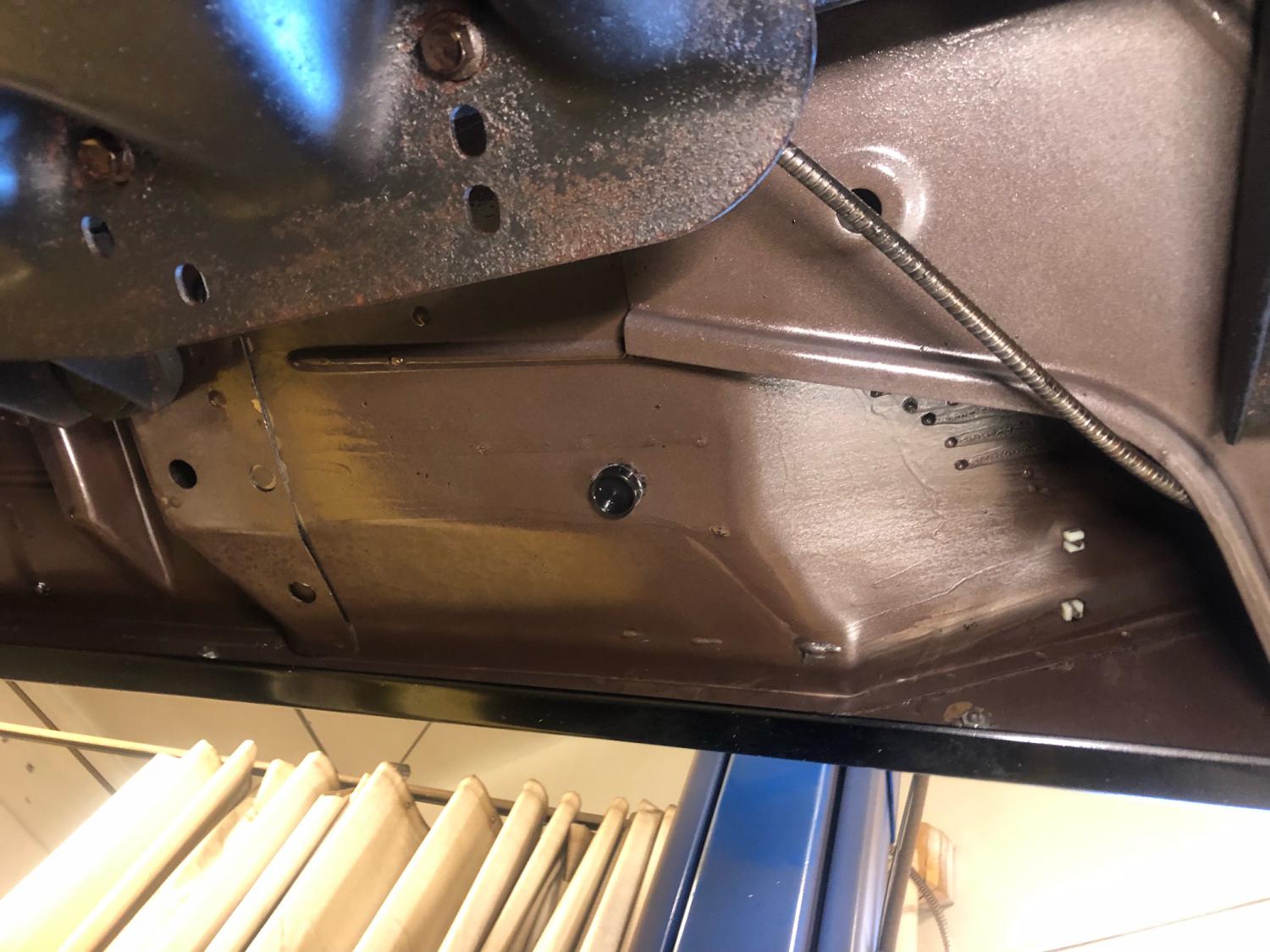

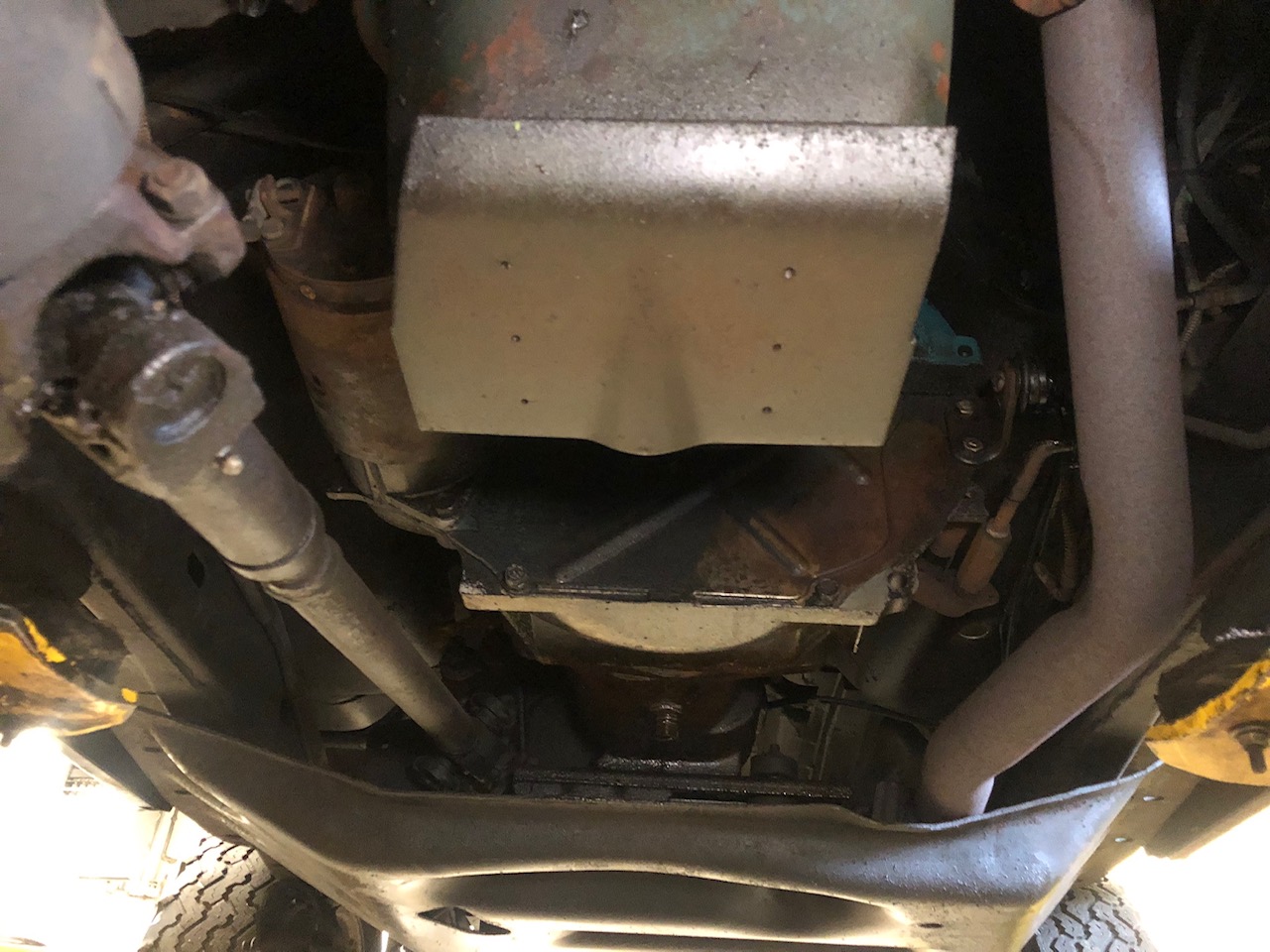

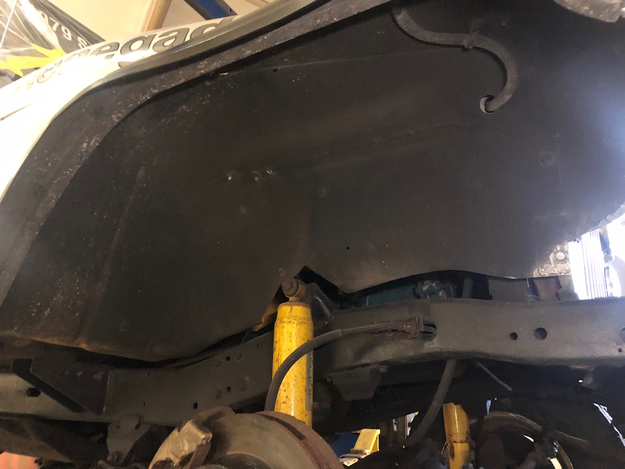

Another amazing 4-wheel drive survivor from the Wayne and Robin Schmeeckle Collection.
It's been a while, but we have several saved up to post.

Well done with amazing results.

That has the big Ford disk brakes, I put a set of those on my CJ5. I think they only used them one year (CJ)

I can't make out the year of the feature CJ, it's got the wide leafs, and amc 20, so thinking 80-83?

75 was the last year for the small leaf springs, and open frame (they boxed them after that). 75 was the last year for a dana 44, and an outside wiper motor.
