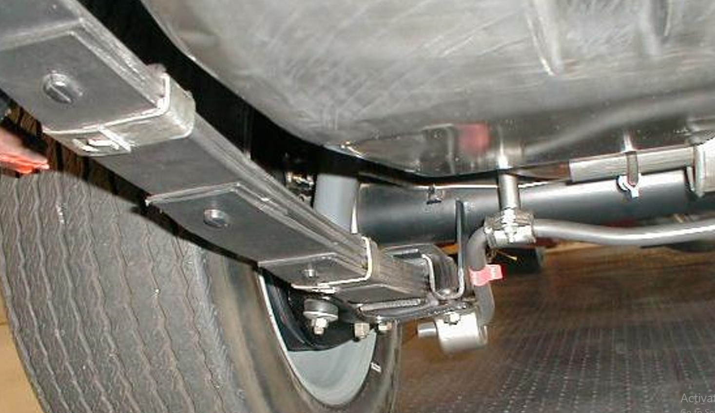

Default sway bar
Pretty Sure it is 4th gen Nova bar which mounted the bushing directly below the inner spring plate bolts
Here's a pic of what is claimed to be a 77 Nova bar on a 73 Nova
Name:  Nova Sway bar.jpg
