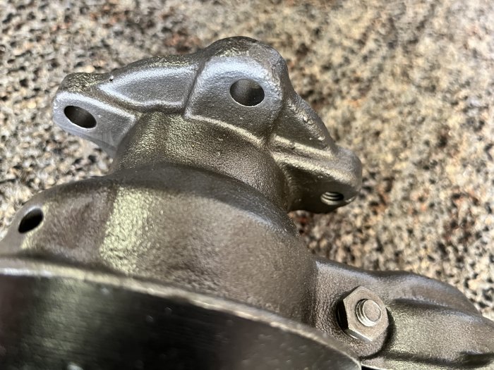

I posted this over at the 348/409 site but looking for help here as well.....
I purchased a restored dated starter for our 62 409. It appears that the incorrect starter currently in the car bolts in with 3 vertical bolts from the bottom of the starter into the block - the correct restored starter bolts with 3 horizontal bolts into the bellhousing. Do I now just need the correct hardware for the bellhousing mounts or anything else?
Don't mind the custom road draft tube bracket....
Thanks in advance.

I don't see where your current bellhousing will accommodate 3 fasteners, only 2. Didn't the '62 have a cast bell ? I can look at the one I have here and see if it has 3 mounting holes.

The new flange style starter is for a Manual Transmission.
This shows the three bolt holes.

Ah, the bottom hole is in the casting but couldn't see it from the back.
Is the one in the car now for an automatic then?

I know for a fact that the bolt to the block style starters were used when a Turboglide was installed, as far back as 1957.
Yes, according to my part book.

If you want the starter to be more correct looking, originals had a pin going through the fork that was held in by a snap ring, not a bolt and nut affair.
Thanks - do you have a picture of what that looks like?
