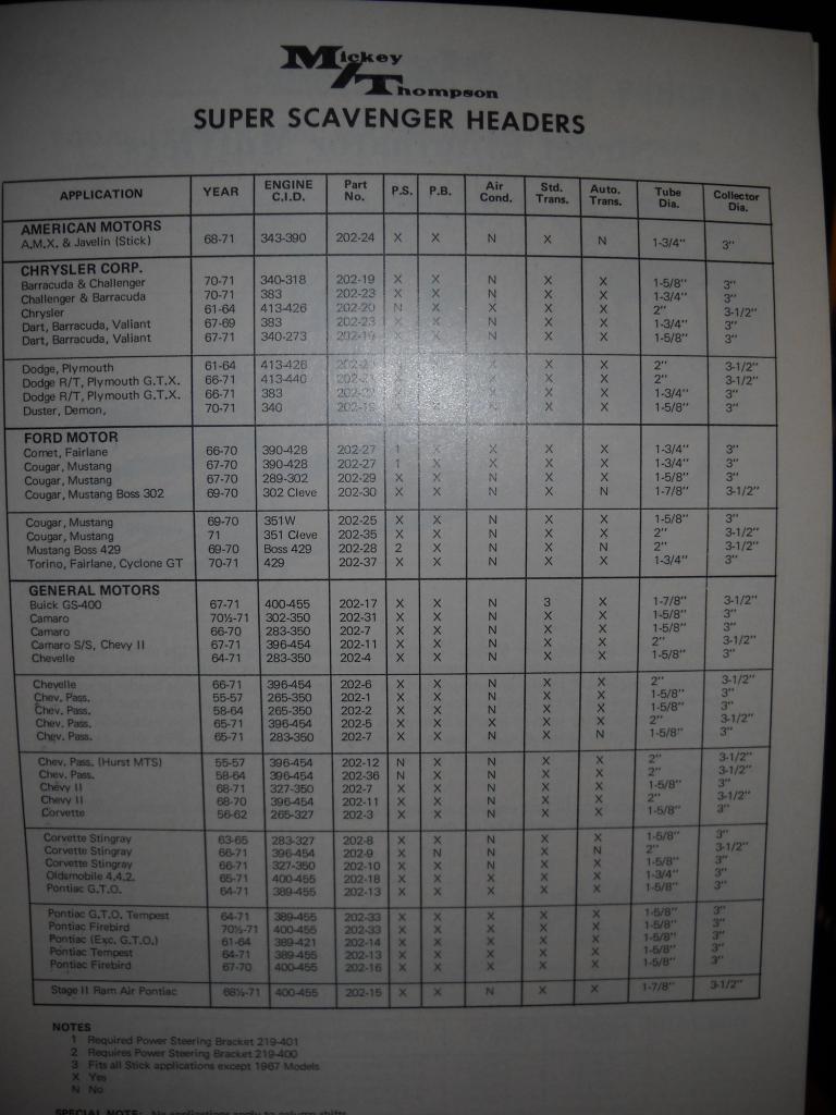

64-71 GTO is noted as #202-13 + 202-33 w/ 1-5/8 Tubes and 3" Collectors on this '71 M/T Scavenger List below.

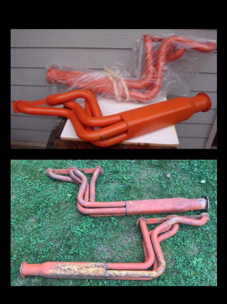

Comparing yours w/ this Round Port set reported as 68-72 from this thread...
https://www.yenko.net/forum/showthread.php?p=1237317 , tube routing appears similar other than 2'nd from front Driver's Side and Pass' front, likely for AC/Alt/Smog pump clearances but Cool is how yours appear way longer total length.
So, possibly 64-67 or later if few accessories also longer length needs more investigating...maybe off-road pipes?
Best of luck confirming what you have, M/T Super Scavengers are Super CL!

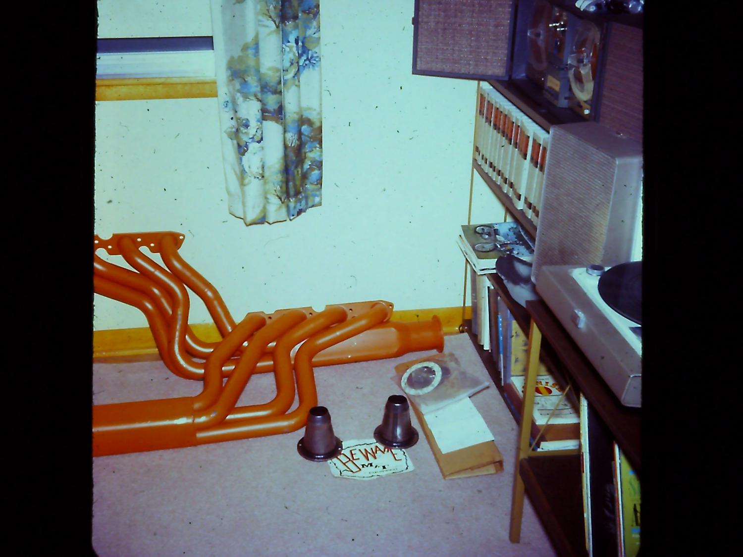

I thought some of you might enjoy seeing my original set of M/T Super Scavenger headers for my 1967 L78 Chevelle SS back in '67 or '68. I installed them myself with the help of a friend. As I recall they didn't rub at all anywhere and the sound was simply spectacular! I believe I had to loosen a motor mount is all to get some clearance during the install.
Not too loud either with stock mufflers, but with a solid lifters HP Big Block there was nothing sweeter sound-wise!
John
