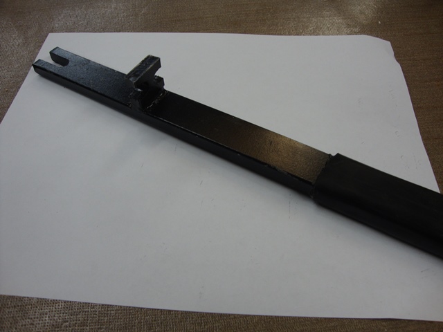

What cool tool have any of you bought or made to install trunk torsion rods. I've got a 70 Judge I need to install the correct rods in (spoiler). Virgin territory for me. I have my jock and cup ready to go

I think I saw this "TOOL" in a old camaro catalog, So I mocked it up and built my own.
Flat bar, Hack Saw, Bridgeport knee Mill, Wire feed MIG welder, Can of black spray paint, Heat shrink, Heat gun, Done. Works great.
Photos attached.
Photos attached.
Made one almost like that ... rods are installed ...
