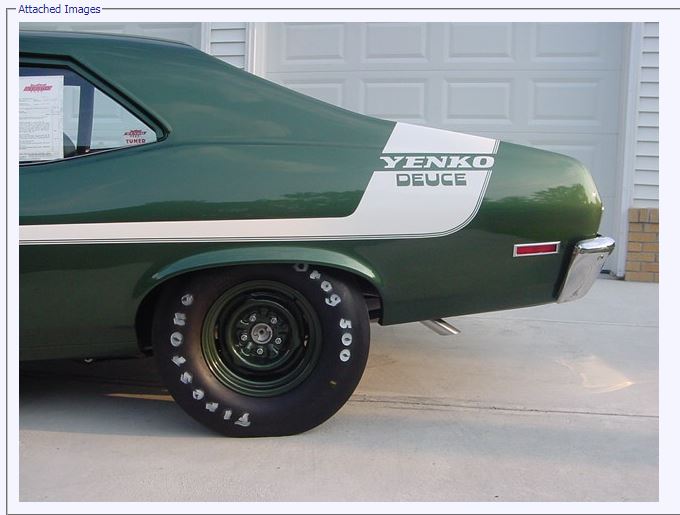

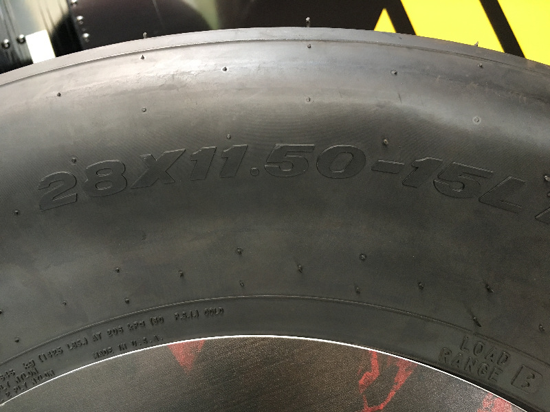

Looking for suggestions for a DOT approved slick with a day2 look that I can buy off the shelf..
70s look.....215-235
This look is just awesome...
Attachments - The Supercar Registry Woodward2008032.jpg SnipImage.JPG mt3.jpg mt2.jpg

Great info, thanks for doing the legwork and laying out the nutshell version for the rest of us!
And the OP is so right, just an awesome look!
