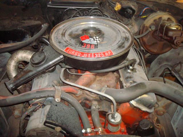

This is a picture of a very original 69 chevelle L34 automatic I had bought from the original owner. The air cleaner lid is chrome
