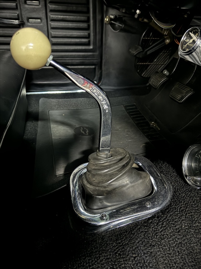

Mitch, these pages may help you understand why pinpointing application is so difficult, and where the "4" comes in?
The stick in my 'ol red car is very similar your's.

Closeups for you Mitch..
