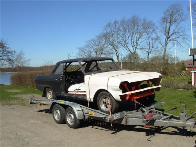

No it´s not my car. Lenny who owns it now bought the front sheetmetal a few year ago when the former owner was going to build a racecar out of it. That guy put a rollcage in it but didn´t cut it up. When he lost interest in it recently, and wanted to sell it, Lenny happened to see the ad and bought it right away. He new it had a good body with little rust (and the floor shift hump is all there) so he didn´t hesitate. After learning that it was sold new in his hometown Karlskrona and that it was originally a 4-speed V8 car, he decided to start restoring it back to stock. Lenny wanted to make sure that the rumours about it being a V8 car was true, and now he knows for sure.
He has found a -67 Chevy II ´194 block and most of the parts he need. It will not be a totally numbers correct restoration, but he wants it to at least look correct. Lenny is still looking for 1964 bucket seats. He currently has buckets from a -65 but knows they are different.

And here is a pic of Lenny´s 1964 SS, taken when he picked it up.
Anders Stålklint.

That's cool that it was sold new in his hometown. Hopefully he got some trim with it. That'll be a nice car when done. Tell him we wish him luck and post any other pics of it when possible. Does he have the carpet rubber shift-hole trim piece? The repros are nice but I'm not sure what's left (brown & black maybe) or if they're going to make more.
