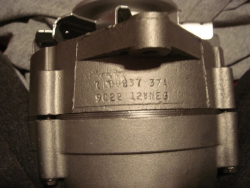

Real or fake? This belongs to be me so don't worry about offending anybody. Thanks guys!

It's there now Dan. I have a larger photo if someone would like me to email it to them.

IMO I think it is a made up 837. Compare the #7'S between the PN# 837 and the amp rating 37A.
The 37A is the way the 7 should look, notice how the lower leg of the 7 is different.

My thought was the 7 in "37A" may look that way due to a light stamping. The bottom of the 7 sort to disappears thus losing the strong curve. Every original I have seen, the "7" has that curve in its back.

It is a restsmp for certain.

Is the "hook" fan on the 837 alternators a later in the year part? I have an 8L alternator with the same fan shown in Jason's picture.
