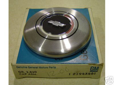

How do you tell the difference in the original and repo wood wheel horn cap?

Show me a pic of the back.

There are several places that make repro horncaps.. Trim Parts makes the best one, but it is not indistinguishable from original, and carries its own part # cast on the back, not a GM #. The most notable difference is the black paint behind the bowtie is usually just flat black on the repros, and originally it was a textured, almost "wrinkle" finish. The red, white and especially blue paints are a little brighter than the original GM shades as well...The rivets holding the inside retainer in are a bit different looking too, but still come loose just about as easy as the originals did. I have seen the repro caps for as cheap as 27.99 on ebay, plus shipping. The GM cap is no longer available, but a few NOS ones are still floating around at swap meets, ebay, etc.

Thanks,the one I have must be a repo.it doesn't have a part number,it has some kind of a shield mark on the back.and it's flat black.the one in the attachment is on e-bay.it's a little more then 12 bucks now.http://cgi.ebay.com/ebaymotors/ws/eB...RK%3AMEWA%3AIT

Thats Jim @ Heartbeat city.Ends 7:30 tonight.
http://cgi.ebay.com/ebaymotors/ws/eB...tem=4522868121

Does that box say $12? I'll take it!
In todays market change teh peroid to a comma and move it between the 1 and 2. I think the repro parts are flatter overall than the GM ones too...
