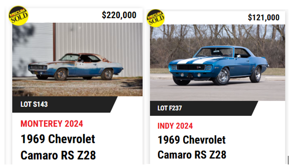

Don't laugh.
Lots of people out there who don't think they need help. The car on the right is a 16k mile completely original survivor.

Originally Posted by William View Post
Don't laugh.
That was Paul walkers car so I’m sure people were bidding crazy because of that
