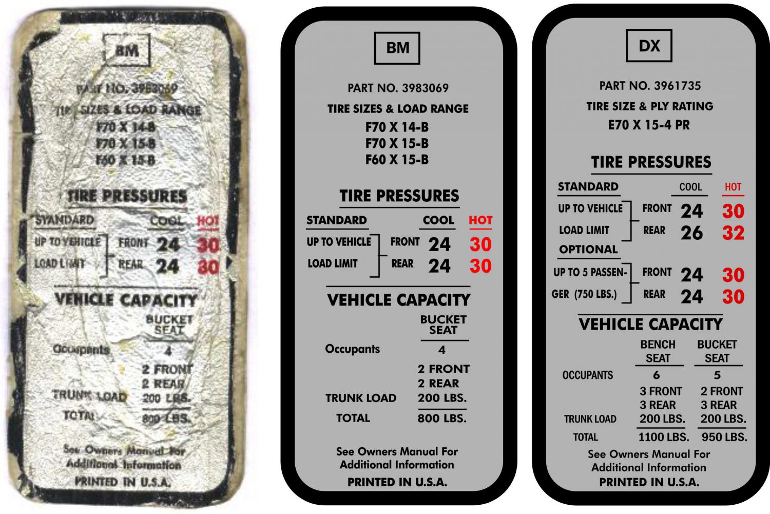

Greetings all,
I am in the midst of a project to faithfully recreate restoration detailing decals for the 1970 Chevelle community. I'm currently in search of surviving examples (whole or partial at this point) of the BD tire pressure decal.
My reference so far is almost there, however I'm missing two major areas:
#1 - the complete part number. I can read all but the last digit: 398218_
Can anyone provide a photo of the complete number?
#2 - left-side middle... which covers the loading details. A photo of this missing fragment is also greatly appreciated/needed. I could technically "guess" and use the info from other decal that are similar (EZ & BC), however I would prefer to be as close to actual as possible.
Photos included for detail and clarity of what I'm missing. Thank you!
