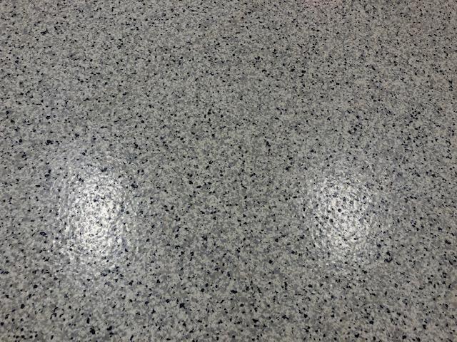

I am building a new garage, and was of the mindset to put down a good epoxy that will resist solvents etc. A nice commercial grade material, but a buddy suggested that I just polish the floor. I thought about and considered this may be a good option. I know this is used in offices in some applications but did not know if anyone has used in their shop. Anyone have any experience with this?

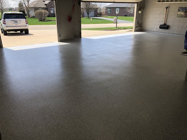

We did an clear epoxy coating over old concrete that was ground down before flooded with epoxy. It’s done well except for a few areas where it got chipped.
Completed floor.

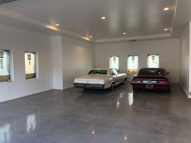

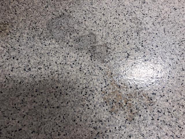

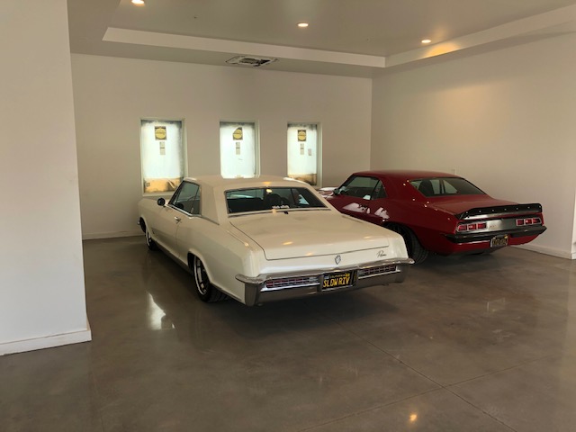

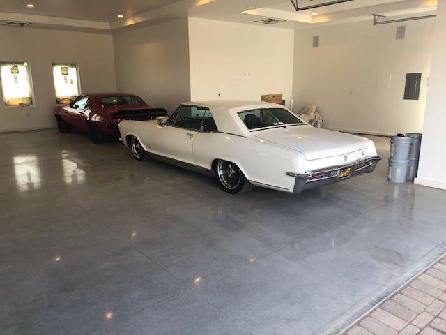

Just finishing a new garage and had the concrete polished. I would do it again. I have epoxy in one of my shops and what was supposed to be non staining etc is staining etc. Floor is actually dirty in these pics.

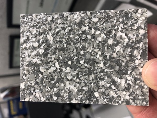

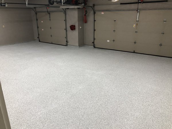

After 16 years of use I had some salt pitting on the floor that I needed to address...…….and like most car projects it evolved into something larger........a garage refresh with new lighting, paint, furnace, and some other things....
I work in the commercial construction business and chose to use a SikaFloor system based on recommendations from a vendor that I had 25 years of good experience with. It is a 3 step, seeded system. First day they come and grind the floor and install the base color and chips, second day an initial clear coat and more chips, 3rd day a final gloss clear coat.
Not inexpensive for sure, but very happy with the results and performance. I did not want to mess with the home store do it yourself kits that start to fail after 10 years or so. Very impact resistant with floor jacks, jackstands, dropped impact sockets (just used them last night), highly resistant to everything I have put on it so far (melting salt water from cars, oil, grease, gasoline, mineral spirits, etc.)

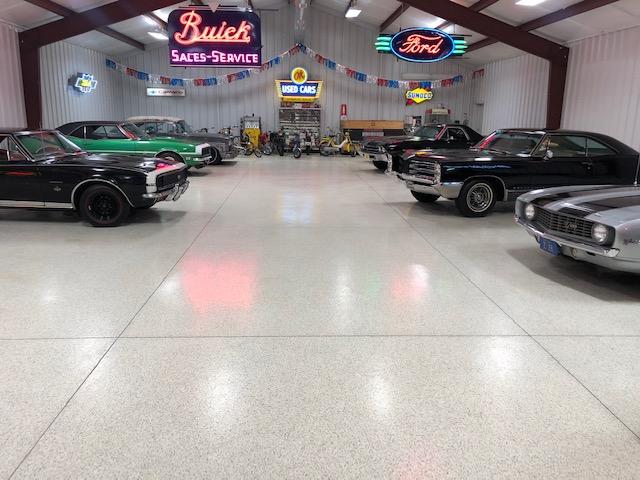

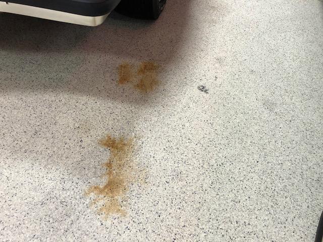

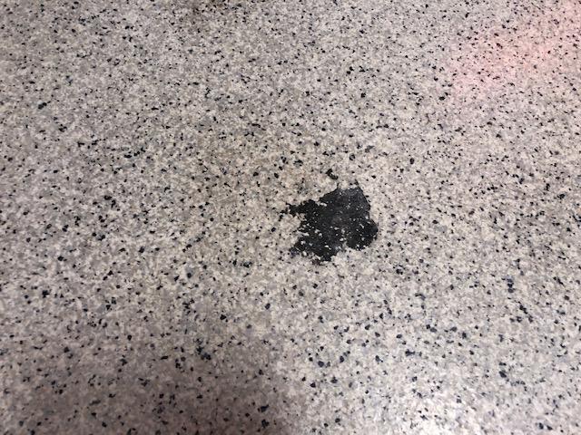

Here is my shop floor I had done in 2004. Was a new slab that I let sit for a few months. Supposed to withstand everything etc. Expensive 3 part epoxy that looked great for a few years. Mind you this is not a working shop, just a place to park done stuff. After a few years, staining, lifting, hot tires pulled it up etc. Company that did it is no longer in business.
