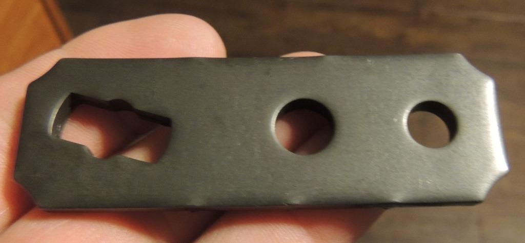

Well, I may not need the reverse lever.
Is this correct? I believe it is a repop or at the very least one that came with an aftermarket shifter.

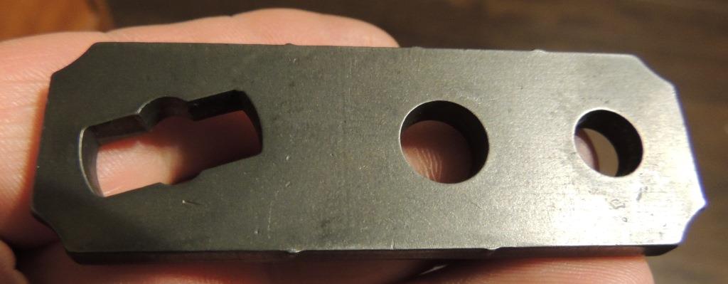

Here are some comparison shots for you, yours might be a repro [img]<<GRAEMLIN_URL>>/dunno.gif[/img]

Default Re: 1969 Camaro SB 3-4 Shifter rod 1885 & Rev Lever
Thanks.
I think you are correct.
I am consistently amazed that they can't get a reproduction part, any part, correct.
What is with the little nubs on the side?
Oh well, probably the last part anyone is going to look at.
My other two arms are originals.
Still need a 3-4 shift rod.
