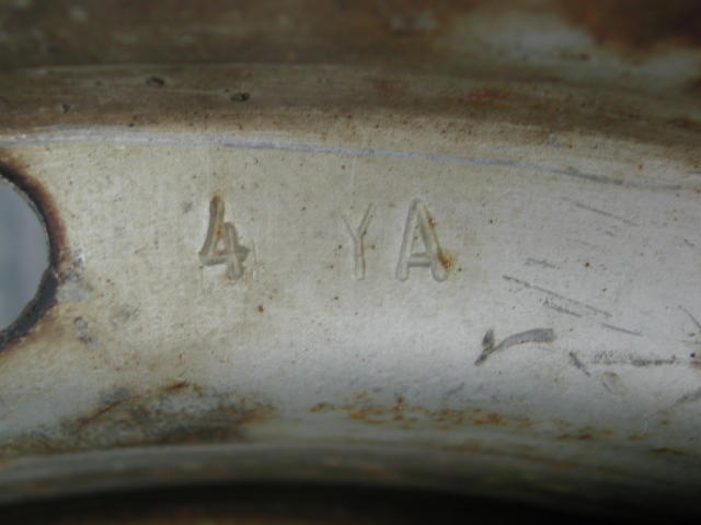

YA code was used on early built 70 SS Chevelles too.Plants differed,but usually the Chevelle YA/AO change over was Oct./Nov. 1969.
Other Chevrolet SS models used these too.1969 SS Camaro-Chevelle-Elco-Nova & 1970 Deuce. Among other things,look for either of these two suffix codes to insure they are for your application.Bring a REAL stainless capped lug nut to insure the holes are not enlarged. |

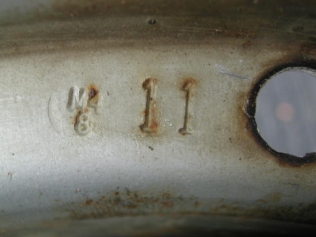

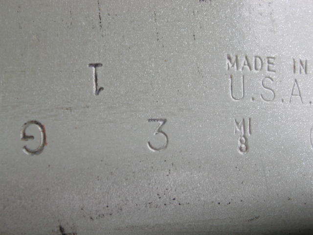

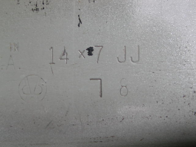

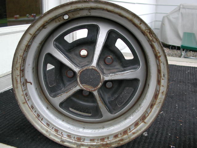

Just happened to come accross a pair of YA's while helping my cousin clean out some rooms in house next to his bodyshop.(well at least one, second one still has tire and trim ring mounted, and I didn't bother to check it)
Mr 70 would you mind explaining how the markings break-down/decode? thanks
