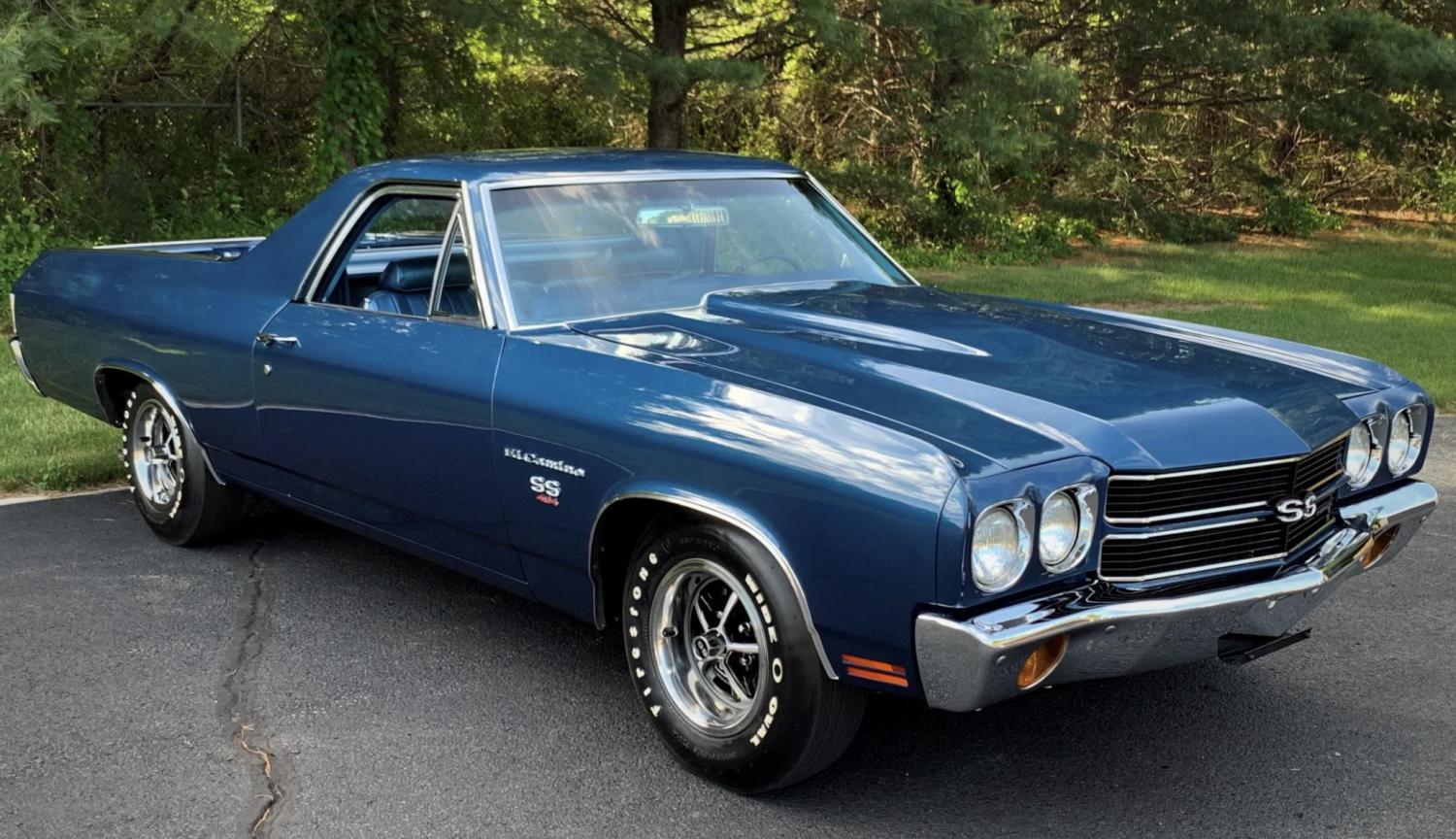

Default 1970 LS6 El Camino on BaT
Love the colors and look. https://bringatrailer.com/listing/19...-el-camino-41/

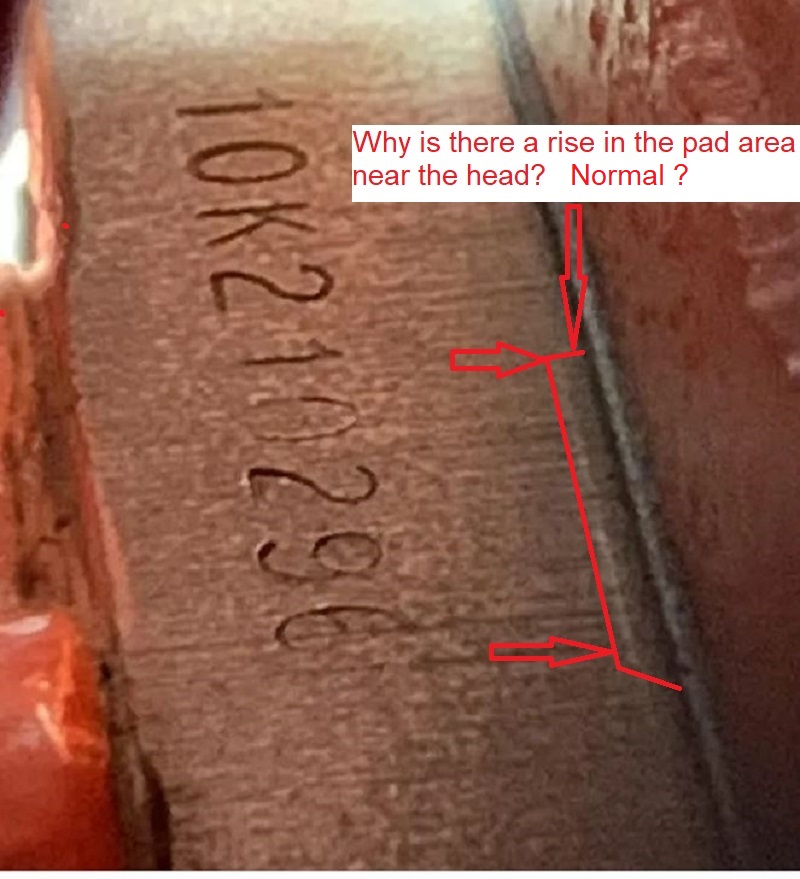

Opinions on pad and trans stamp???

The engine is an obvious restamp IMO.

That was my insinuation also! Thanks

Default Pad Stamp
I am wondering why there is a ridge/rise in the pad area near the head. Is this some known casting normality? Or is it because it was cut down and they didn't get it set correctly?

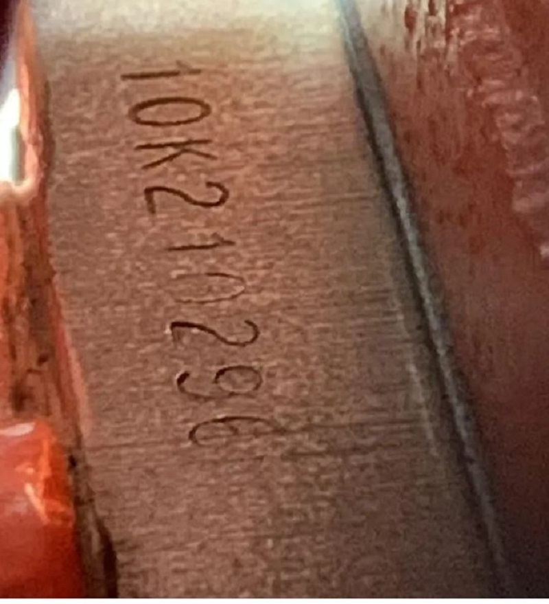

Default Pad Pic
Smaller clearer shot... D
Danny
----The broach marks look OK though. If so, I think your assumption of a step is really farfetched, though not, I guess, impossible. Is it possible that that the edge we see is the edge of the head gasket???....Bill S
Danny
Doesn’t it look like some shadow numbers,especially number 6 above the stamped vin?
