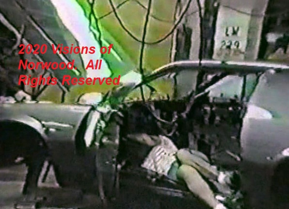

Factory used dish soap, fwiw.

Each worker in the trim shop had a tool box and an apron with front pockets for tools also.
