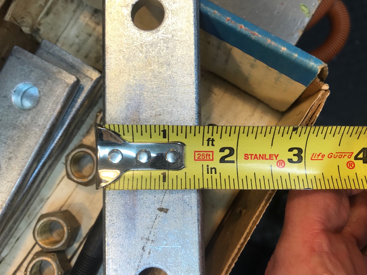

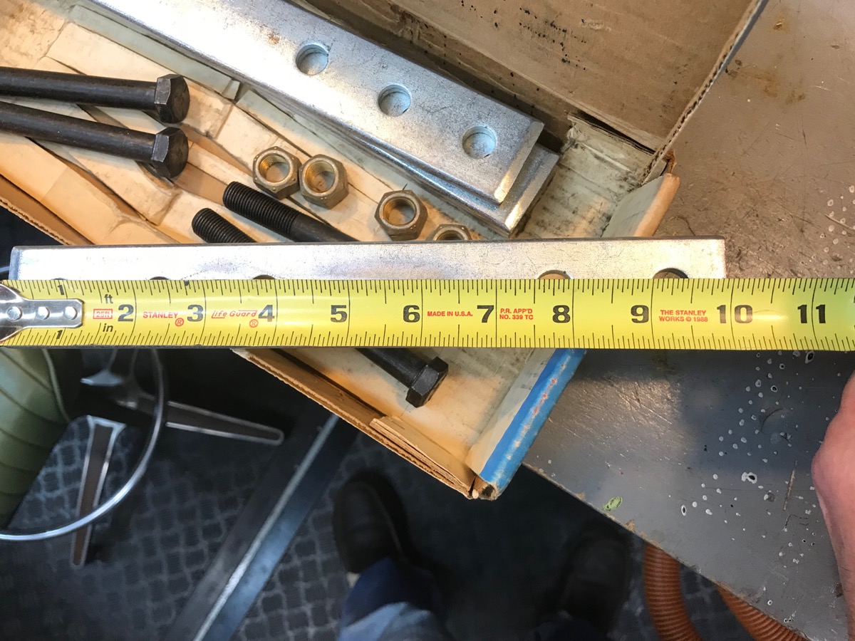

Old 05-08-2018, 10:28 PM
mockingbird812's Avatar
Location: Dayton
Posts: 14,422
Thanks: 913

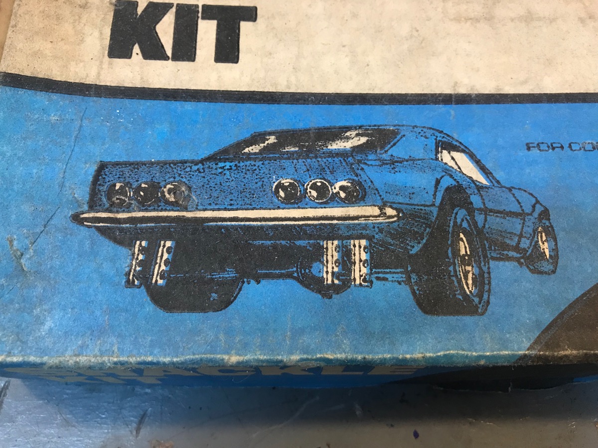

Bentley,
Let me know if these will work for you…
Sam...

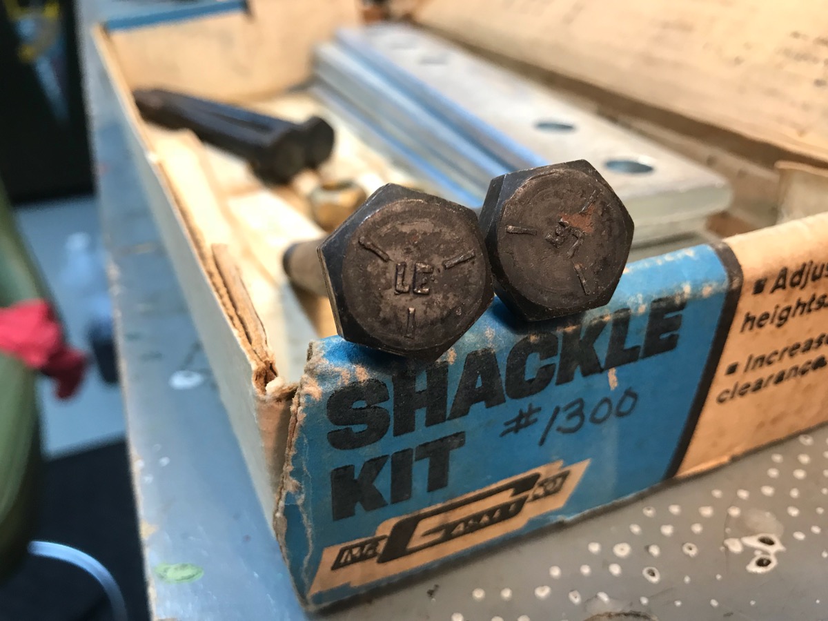

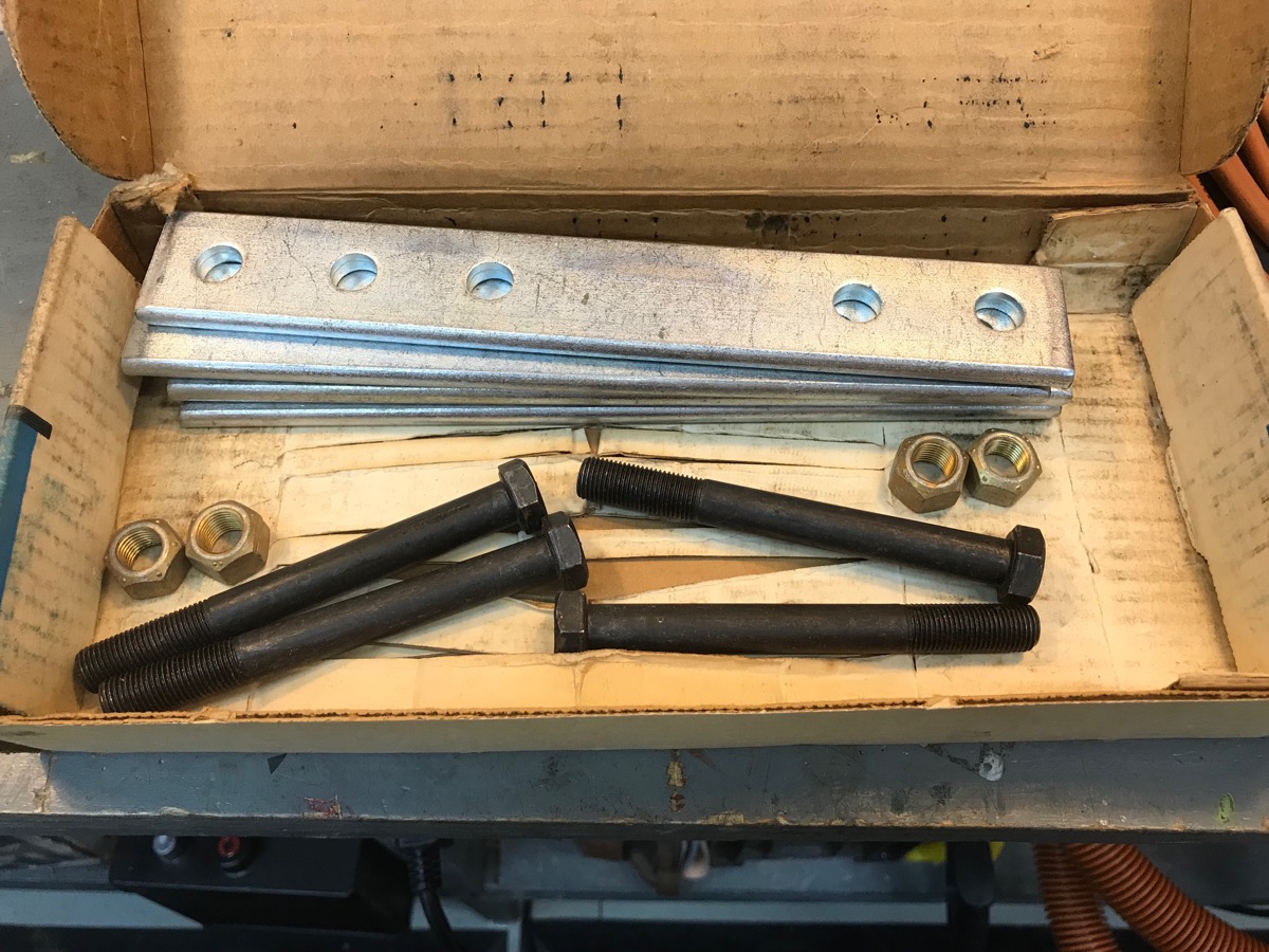

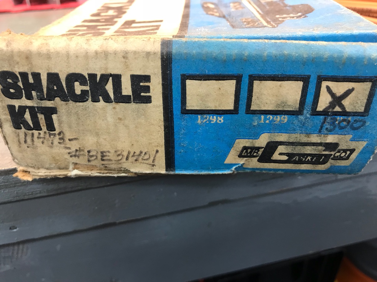

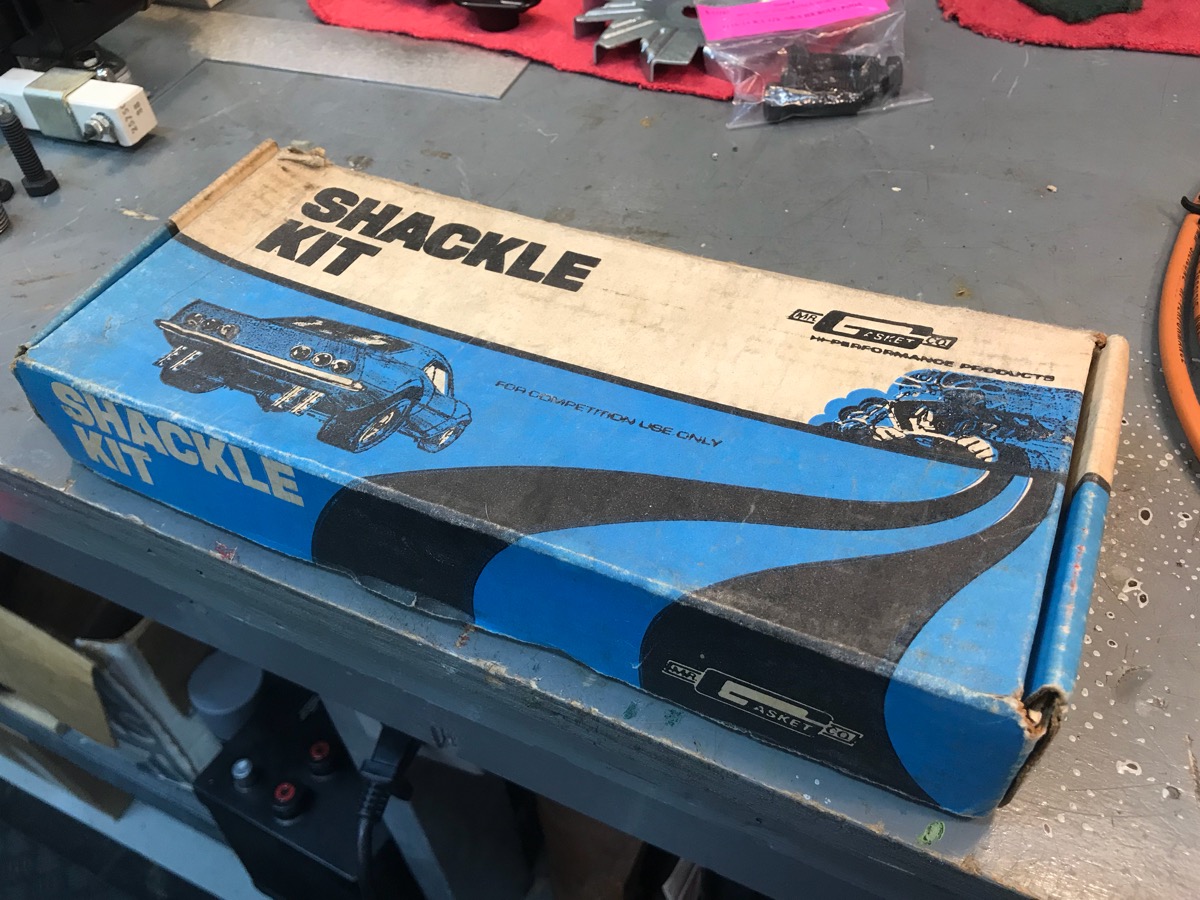

Old 05-08-2018, 10:31 PM
Location: Dayton
Posts: 14,422
Thanks: 913
More info.....
Sam...
bbbentley (05-08-2018)

Dang!!!! Id like those just to display. Of course those would fit what I need. Ill take em !! We will settle up. This site ROCKS!
