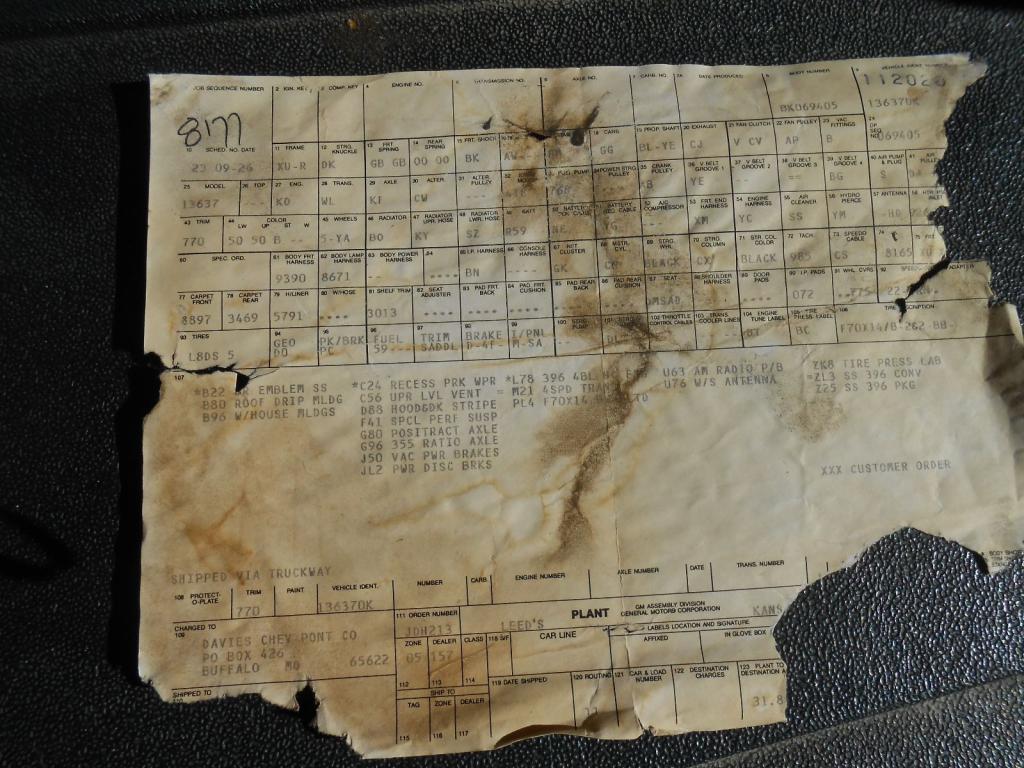

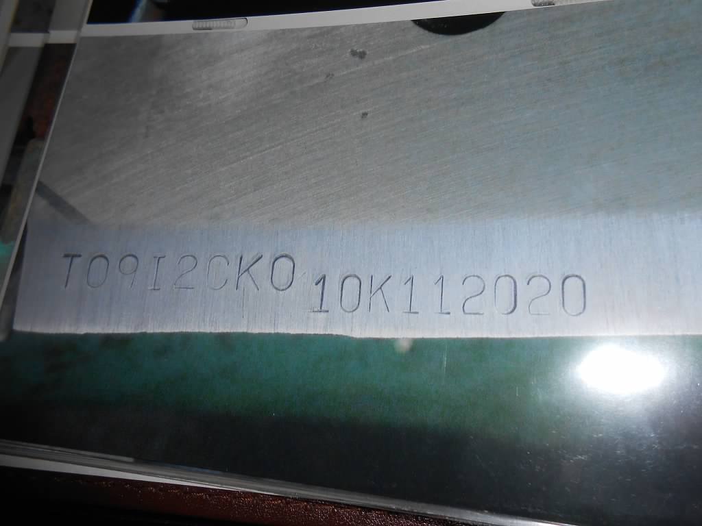

Here are the deck stamps and build sheet for this car...

FWIW, the POP looks OK but way too clean. The block is a restamp and would have actually looked pretty good with the cylinder head on if only they had stamped the VIN the way KC did them All the other stamps also look suspect, especially the axle tube. That build sheet is one of the worst I've seen and should go right into the trash bin. If for some reason this was a real L78, the fake provenance has killed it. It's a shame, looks like a beautiful car.
