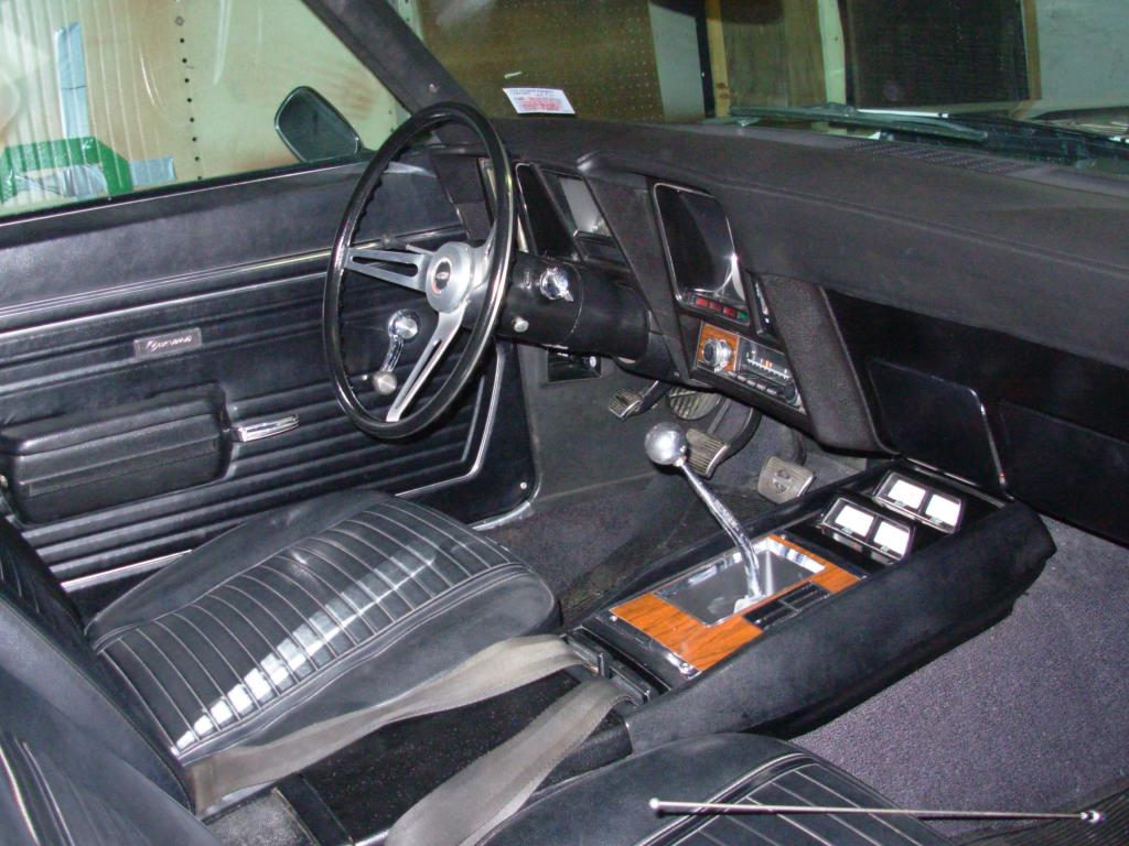

Guys this is photo of his steering wheel that is currently in his car...

That's not the N34 wheel. The N34 wheel was simulated wood, either walnut or rosewood, depending on when it was built. Both very pricey today...Joe
