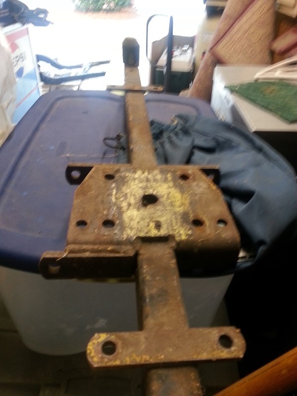

Old 12-31-2013, 10:32 PM
67rs/ss 67rs/ss is offline
Join Date: Aug 2005
Location: joco nc
Posts: 210
Thanks: 12
Thanked 47 Times in 15 Posts
Default Re: ? on 1967 Camaro old drag car.
Here's a pic of the motor stand.

Old 01-07-2014, 02:31 PM
plumL78 plumL78 is offline
Join Date: Jan 2005
Location: 1106 Ogletown Rd. Newark De. 19711
Posts: 151
Thanked 15 Times in 13 Posts
So does your L78 car have a special paint code.
