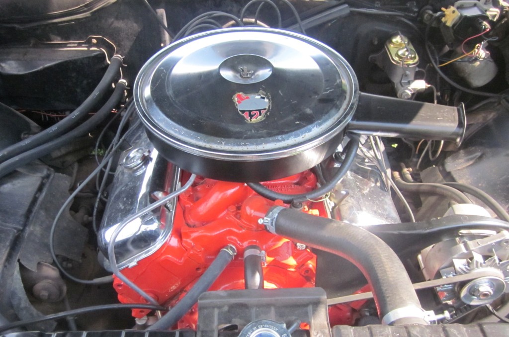

a few months ago i bought a triple black original paint(except hood) 67 ss427 impala.its a factory m20,3.73 posi.i have pop,window sticker,and the original owners just live 40 miles from me!engine was rebuilt back to stock by second owner,but for some reason put in a huge cam and its got to go.im wanting somthin pretty mild.i do like little lope.its does have headers but thats it.

I probably sound like a broken record however I will have to hand it to rollers, solid or hydraulic. You can get everything you want as far as drivable and not give up anything over a flat tappet when it comes to performance. If you are not wanting to drop the coin for a roller and want a nice hydraulic you could go with the factory L68 vette cam or L71 if you want a solid, with the 4 spd you have options.

What intake & carb do you have on this? I think these are cast intake & qjet on the impalas?
At any rate, I have a 454 that made 450hp & 530 tq spec`d as follows (very mild combo)
Crane 284 hyd flat tappet cam (228 @ .050, .544 lift on a 112)
10.5 comp.
cast iron GM qjet intake
Qjet carb
Ex manifolds (dyno numbers with headers)
ported 049 heads with bigger valves
Has a slight lope (stock musclecar sound) but pulls like mad... 530 tq came in at 2500 rpm...

im gonna stay with a hydraulic flat tappet,im still runnin the stock cast iron intake and Q-jet.here are some more pics.thanks for the compliments

Crane 133801. I used one in a <span style="font-style: italic">very</span> mild 9-1 427 that ran 12.70's in a 3600 lb Camaro in the Ohio summer heat (can share details if you wish, don't want to clutter up the thread).
Outstanding torque from right off idle, pulled hard to to ~5500 rpm. Slight lope, less noticeable than an L78 cam (also another outstanding choice).
