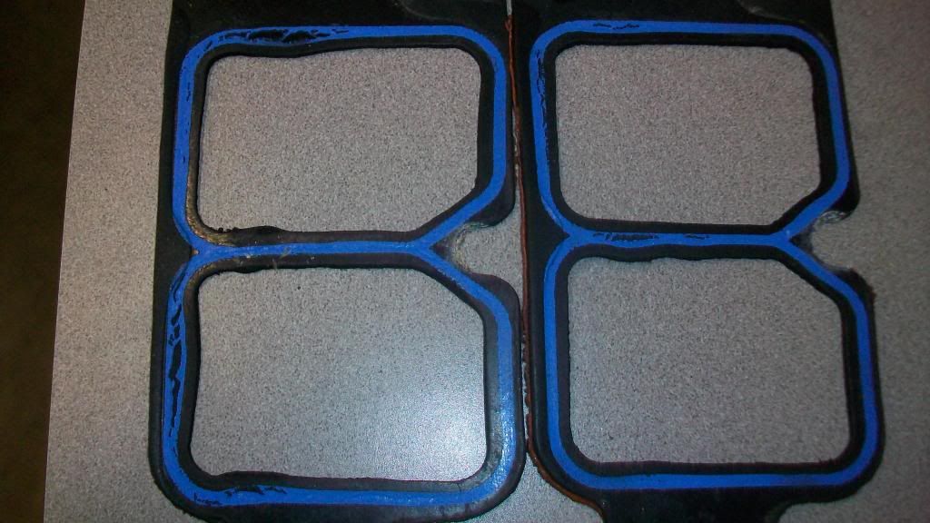

I am making some changes to my motor (intake/carb). When I removed them the other day, the intake gasket (Fel-Pro 1211)was cut/torn in a few spots.
I believe this was due to the ports on the heads being bigger than the intake so when they compressed together, the gaskets were cut.
Any recommendations on a gasket that will work with my set up, which is ported heads and a non-ported intake?
I really don't want to gasket match the intake if I don't have to.
Thanks, Kurt

Have any of you ever seen this happen to intake gaskets? I checked my ports with a mic and the correct gaskets were used.

Overtorqued... [img]<<GRAEMLIN_URL>>/dunno.gif[/img]

<div class="ubbcode-block"><div class="ubbcode-header">Originally Posted By: m22mike</div><div class="ubbcode-body">Overtorqued... [img]<<GRAEMLIN_URL>>/dunno.gif[/img] </div></div>
I remember re-torquing the intake a few weeks after the motor was built so I am leaning towards that being the problem (oops). [img]<<GRAEMLIN_URL>>/blush.gif[/img]
I purchased a set of Fel-Pro MS90005 intake gaskets. They are black with steel in the middle. They are .060 thick with a dimension of 1.82 X 2.54. I think they will work fine.
