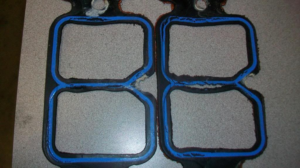

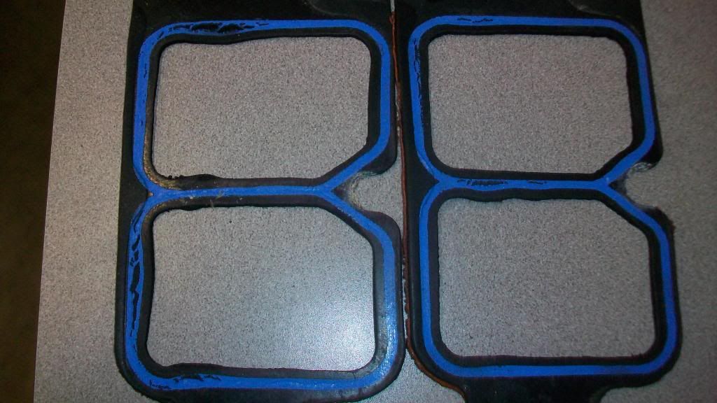

69 Post Sedan 01-08-2012 08:26 PM
Re: Intake Gasket
Have any of you ever seen this happen to intake gaskets? I checked my ports with a mic and the correct gaskets were used.
Kurt
http://i300.photobucket.com/albums/n...e/100_6822.jpg
http://i300.photobucket.com/albums/n...e/100_6821.jpg
m22mike 01-08-2012 09:12 PM
Re: Intake Gasket
Overtorqued... [img]<<GRAEMLIN_URL>>/dunno.gif[/img]
69 Post Sedan 01-09-2012 01:57 AM
Re: Intake Gasket
<div class="ubbcode-block"><div class="ubbcode-header">Originally Posted By: m22mike</div><div class="ubbcode-body">Overtorqued... [img]<<GRAEMLIN_URL>>/dunno.gif[/img] </div></div>
I remember re-torquing the intake a few weeks after the motor was built so I am leaning towards that being the problem (oops). [img]<<GRAEMLIN_URL>>/blush.gif[/img]
I purchased a set of Fel-Pro MS90005 intake gaskets. They are black with steel in the middle. They are .060 thick with a dimension of 1.82 X 2.54. I think they will work fine.
Kurt
