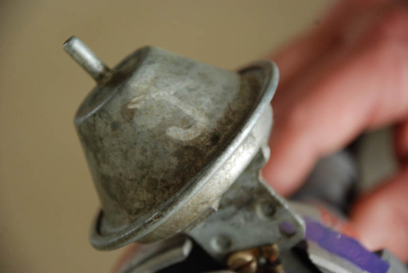

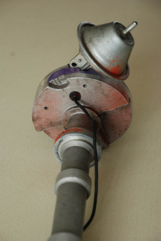

I have a 170 distributor which appears to be a low mile take off, I would like to know what the purple paint marking means???? Also there appears to be a J on the Vacuum unit. What would this mean aswell??? Thanks

vacuum unit marking

One more of purple marking

Are you sure that "J" is not a "4"...???
Many times the vacuum can was marked with the initial timing setting in crayon...4* is a common marking. I believe the purple paint is an inspection mark...other experts may chime in.

According to Colvin, the paint stripe is to identify the distributor without having to read the number on it.
Distributor Color Coding
Most distributors installed at a final engine assembly plant had a color code applied to the distributor housing. This was to enable engine assemblers to identify a distributor without reading the code numbers. In time, many of the paint codes wore off. Most Delco Remy blueprints call out these codes as paint spots.

Great info...I checked our 1968 dated 170 and it has the purple paint mark....

from what i've seen and have herd most of the solid lifter cars had the purple marking on the dist

vacuum unit marking
wilma
Ah yes it does look like a ''4'' now that I look at it at another angle.

The initial timing on the vac can makes alot of sense.
