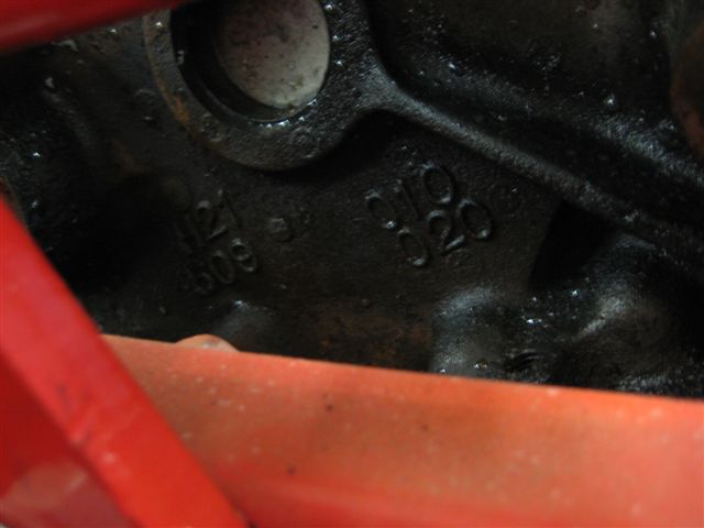

Here is a 4 bolt 010 block with the 010 and 020 cast into it.
So would the nickle content markings be different for say the 270 hp vette block?
Carl

I believe they would be the same.
