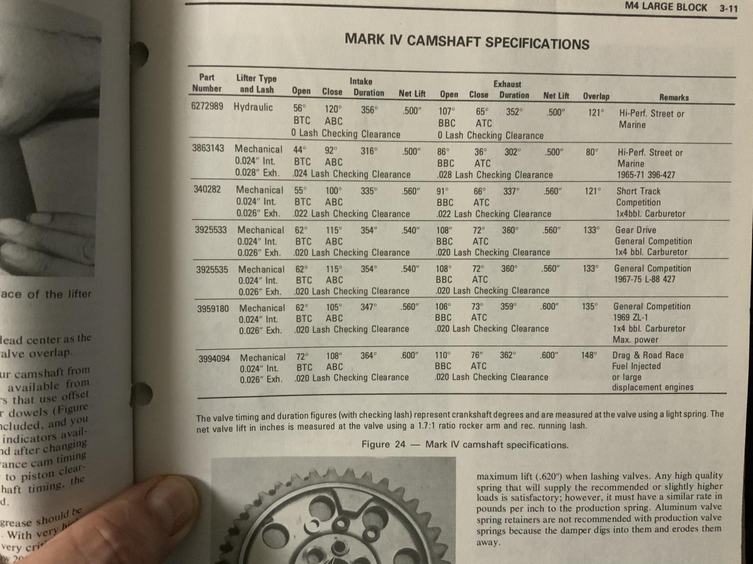

What is a “2nd design” cam? I am building a correct ZL1 for a 69 Camaro tribute project.
The and design cam is the 180. The 5535 was the first design used with the early heads.
