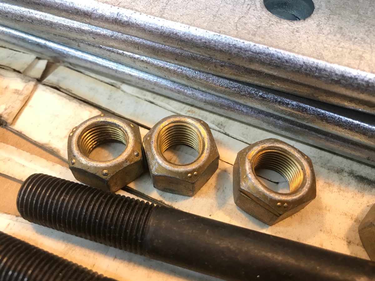

Bentley - I have a set. Let me dust 'em off and see what I gots!

Bentley,
Let me know if these will work for you…
Sam... ![]() |
![]() ![]() Dang!!!! Id like those just to display. Of course those would fit what I need. Ill take em !! We will settle up. This site ROCKS!
