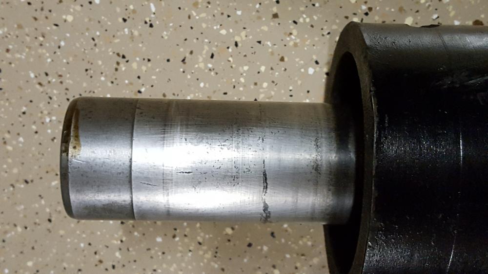

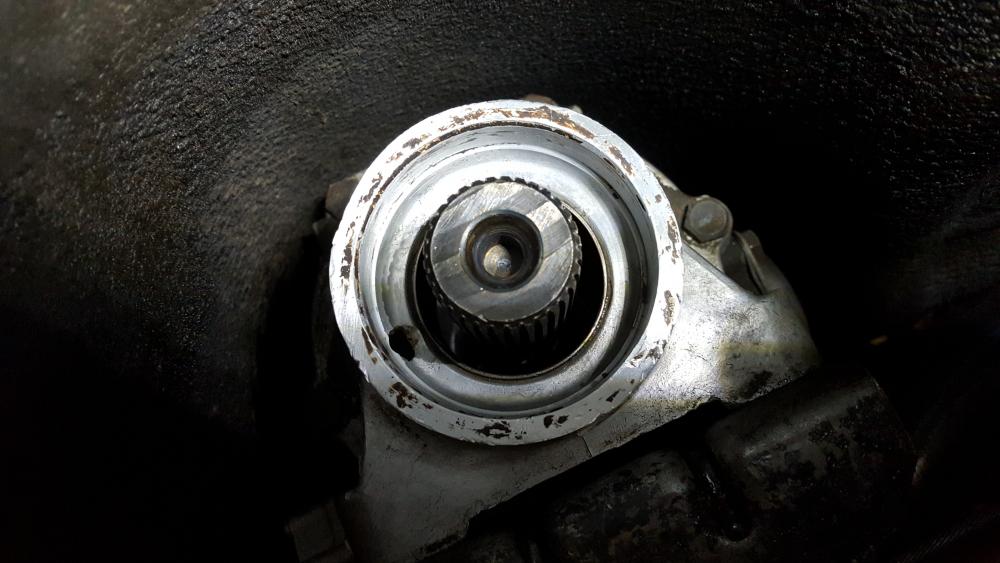

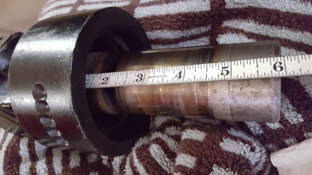

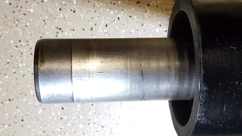

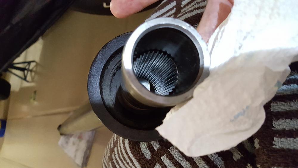

On the way home from Pavilions, the tail shaft seal fell out of the rear transmission housing. When I removed the drive shaft, the seal was in the collar.
There does not seem to be excessive play in the rear shaft when the drive shaft is still in the trans, but the front u-joint made noise. When the drive shaft was on the floor, I noticed the front joint is very loose.
I took a few pics. Am I missing something?

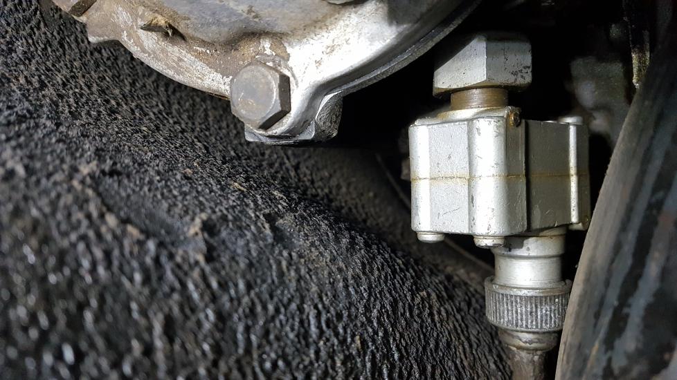

Is this the speedometer gear housing? This is my first Turbo 400.

With the driveshaft back in and mounted and the car resting on the ground, what is your measurement of the slip yoke? General rule of thumb is a two finger measurement. If it's any closer it would be considered too tight and the driveshaft should be shortened.
Old 04-10-2017, 12:34 PM
earntaz earntaz is offline
Join Date: Mar 2010
Location: Republic of Texas
Posts: 4,646
Thanks: 7,309
Thanked 680 Times in 375 Posts
The discoloration on that yoke indicates it may have gotten a bit warm? Also the speedometer adapter is common -- used to correct speedometer reading.
I agree with Dan -- if there is not enough front to rear clearance, the drive shaft will bottom out and raise hell with trans ... TAZ
Old 04-10-2017, 03:08 PM
Posts: 10,330
Thanks: 3,172
Thanked 4,599 Times in 1,142 Posts
The front yoke is likely toast as is the tail shaft bushing. The U-joints look like they are maybe original. Look to see if there is no zirc fitting (seems to me that original Impala u-joints did not have zircs). If not then they are likely originals and should be replaced with the inner lock ring and zirc style.

Finding a slip yoke will probably be easier said then done. It's a 32 spline piece with a damper.
Rick
1966 Chevy Caprice 427-390
Old 04-10-2017, 08:54 PM
Posts: 10,330
Thanks: 3,172
You can also just buy a sleeve for the front yoke and install that on the yoke you already have.
