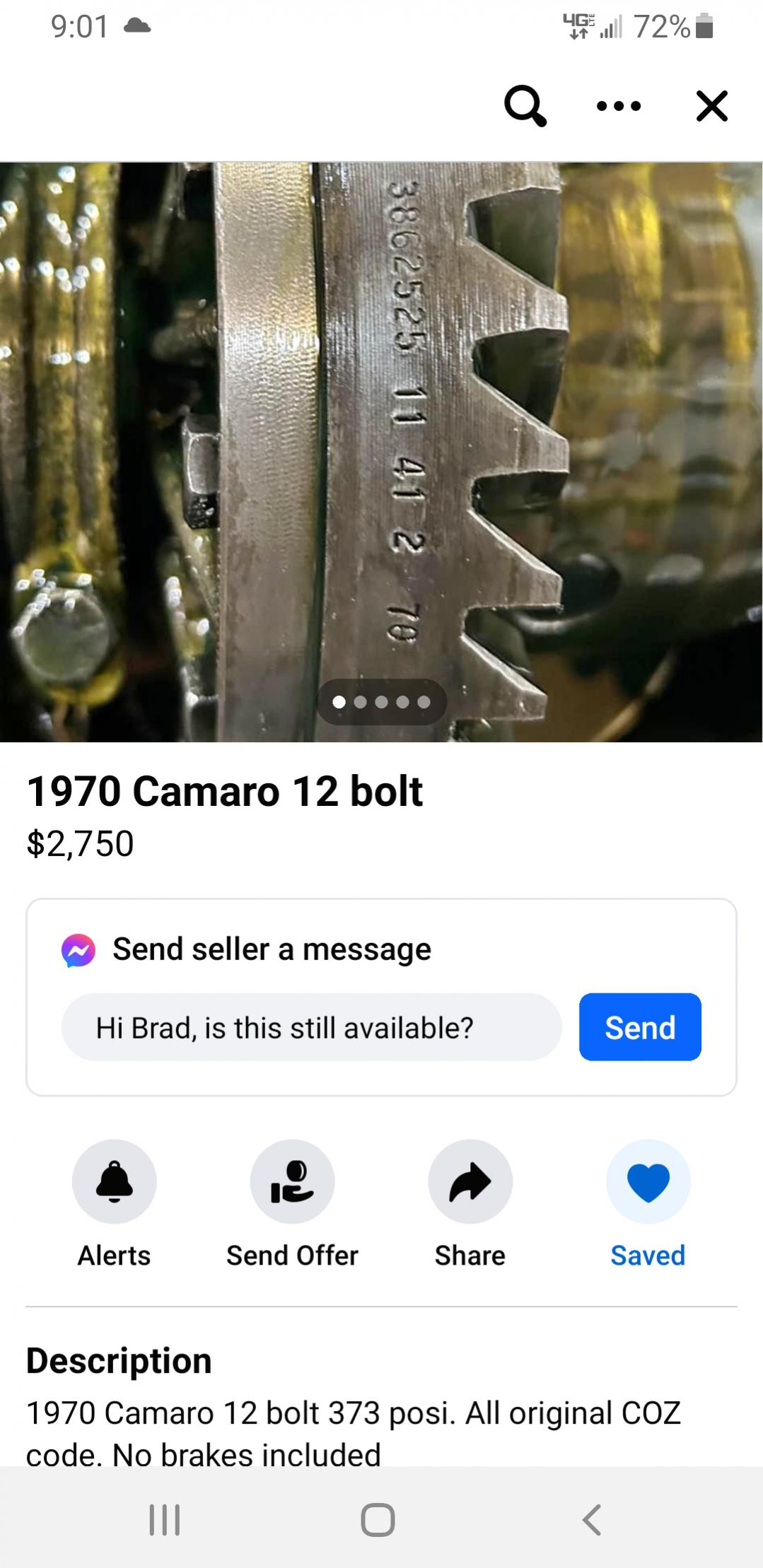

My good friend just scored this 12-bolt COZ coded rear off Marketplace. Looks to be completely original with the dated 3.73 gearset and Eaton posi. Uncut spring perches and all correct measurements. His question, (that I cannot answer) was this specific to a Z-28, RS, or ?? Thanks for any information I can relay to him.

I think just Z. SS came with a 3.55 standard and option was 4.10. Z option was 4.10 too. I've never heard of a 3.73 SS.

I thought a 12 bolt came in any 1970 Camaro with any engine that had a 4bbl, but the 3:73
ratio was standard on the Z-28 with the 4:10 optional. I do not know about the L-78 in 1970,
so my vote is it came out a 1970 Z-28.

Correct Bill...only the Z28 could have gotten the 3.73s. L78s were 3.55 std and 4.10 optional.

RS is an appearance package and has nothing to do with performance, so that wouldn't matter. I would think that it would be Z28 or maybe L78.

As Dave mentioned, 3.73s was a Z28 only ratio for 1970, but the COZ code was also used in '70 T/As as they shared the same 12-bolt as the Camaro that year. Either way, that's a great score!
