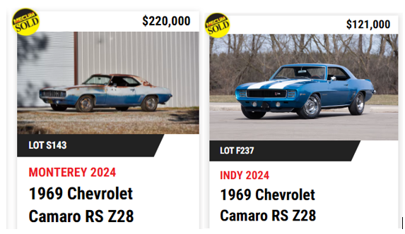

So you guys thinking 270k on this one? Lol

Don't laugh.
Lots of people out there who don't think they need help. The car on the right is a 16k mile completely original survivor.
