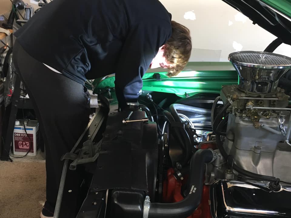

Here's another view. Also while you are detailing, I have two big block top radiator hoses - that I believe are original - and notice that the hose numbers face away from the front of the engine bay. The repro hoses I see have these numbers facing forward.

I still have the original radiator hoses on my unrestored L34 Nova. The top hose part number is facing the engine, which is correct. I see what you are talking about by looking at Marlins green Nova. I'm sure all the repops are this way... They can't even get that right.
