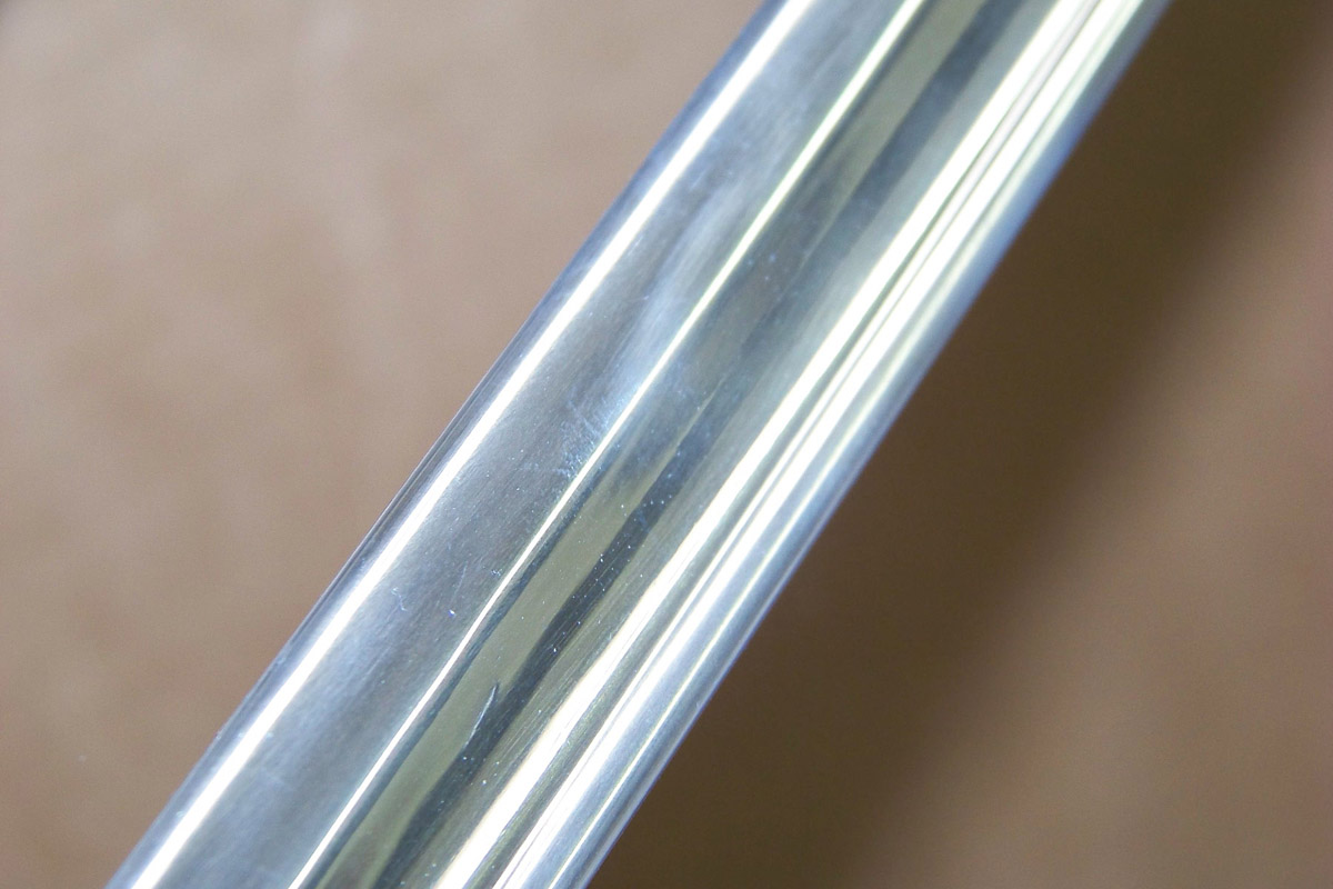

I stripped the anodized surface on moldings from my 71 Nova. Polished them to a chrome-like finish and sprayed Boeshield T-6 on them to protect ... Craig
