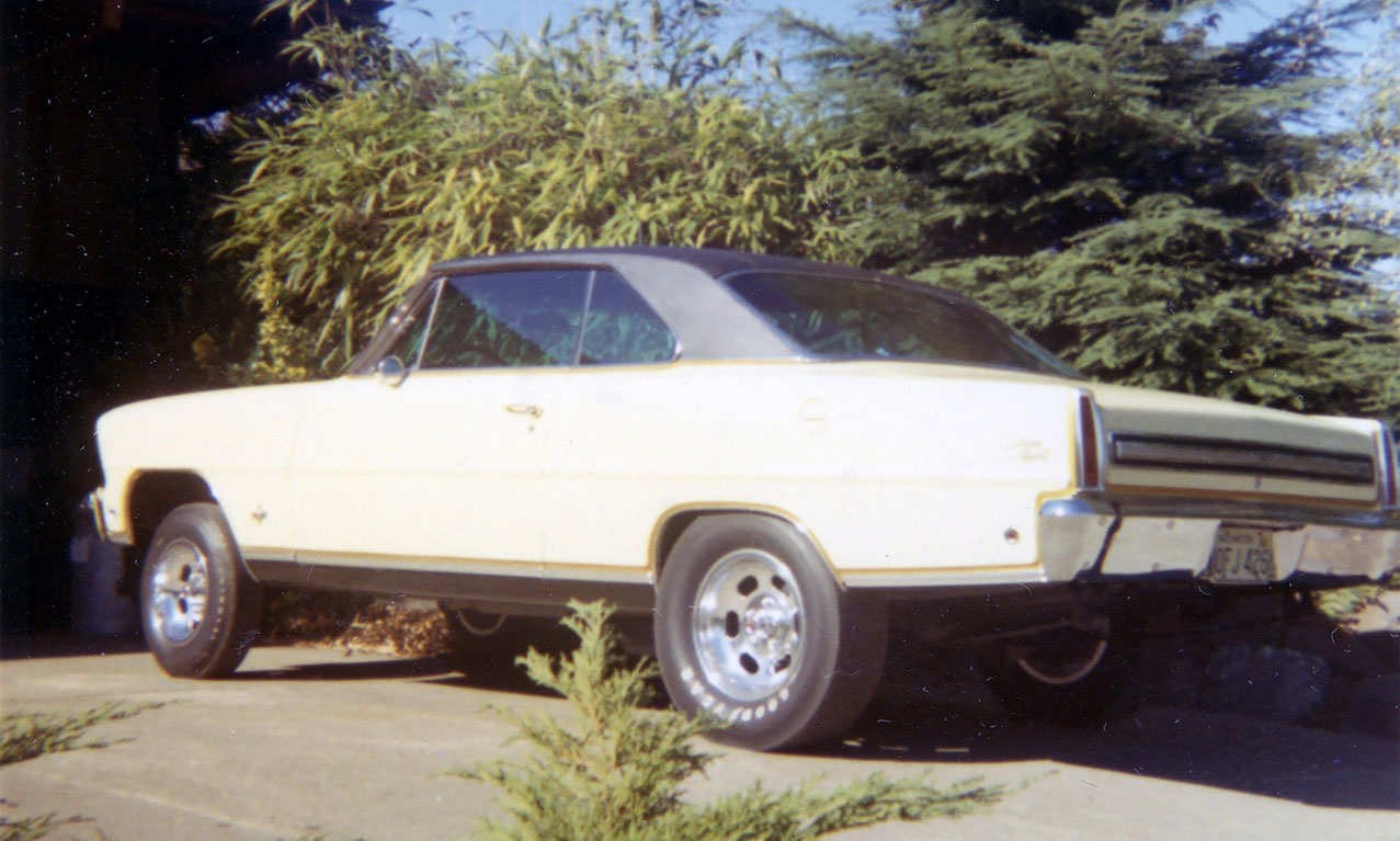

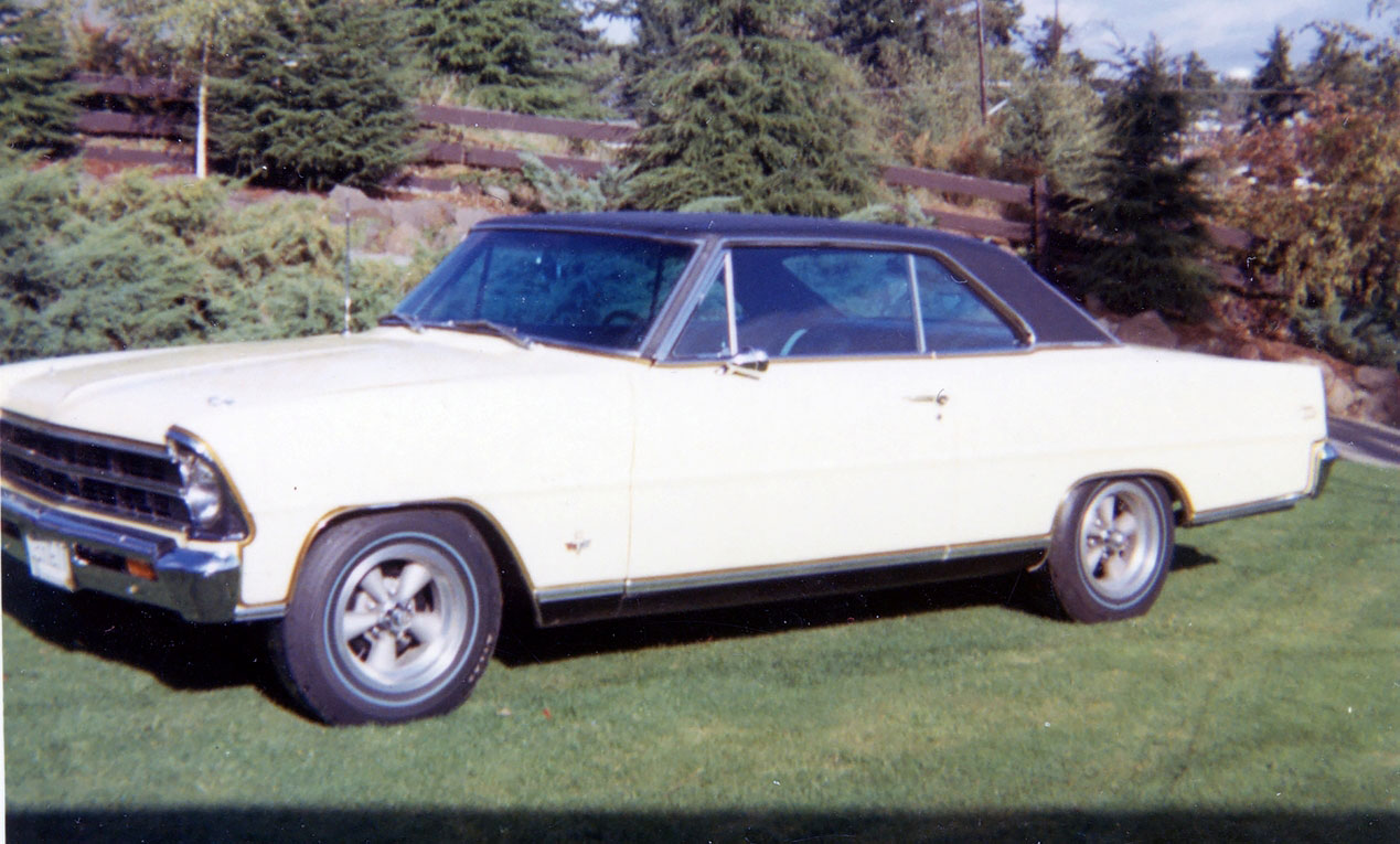

Wheels: What wheels with white walls and what wheels with slicks and jacked up front end?

Stock height, looks like Torque thrust 2's for rims. They both have aftermarket manifolds, it looks like. Factory L79 chrome valve covers on the first pick. Neat car...does your dad still have it or you even?

Those are not white walls, they have blue stripes. Probably Good Year.
I've got a pair of 6 hole 8 1/2 inch slots like those. They are market Universal Wheel USA on the back.

I had always assumed they were white walls that were new and hadn't had the blue washed off.
Thanks for the idea on the Universal Wheels USA...I usually see this style wheel in 5 slot but these are 6 as you mentioned...

A drum master has a single bail to hold lid of master on where as a disc master will have two bails to hold lid on. Picture I sent is a manual disc. Yes, your dads car was a 4 wheel drum as most were back in the day. Remember that Disc was not a racing add on for power just stopping better. Disc won't be on the tag but it was an SS 327 car by the fender flags and the 327 numbers above the flags. If it was just a 283, then it would just have flags with NO numbers.
