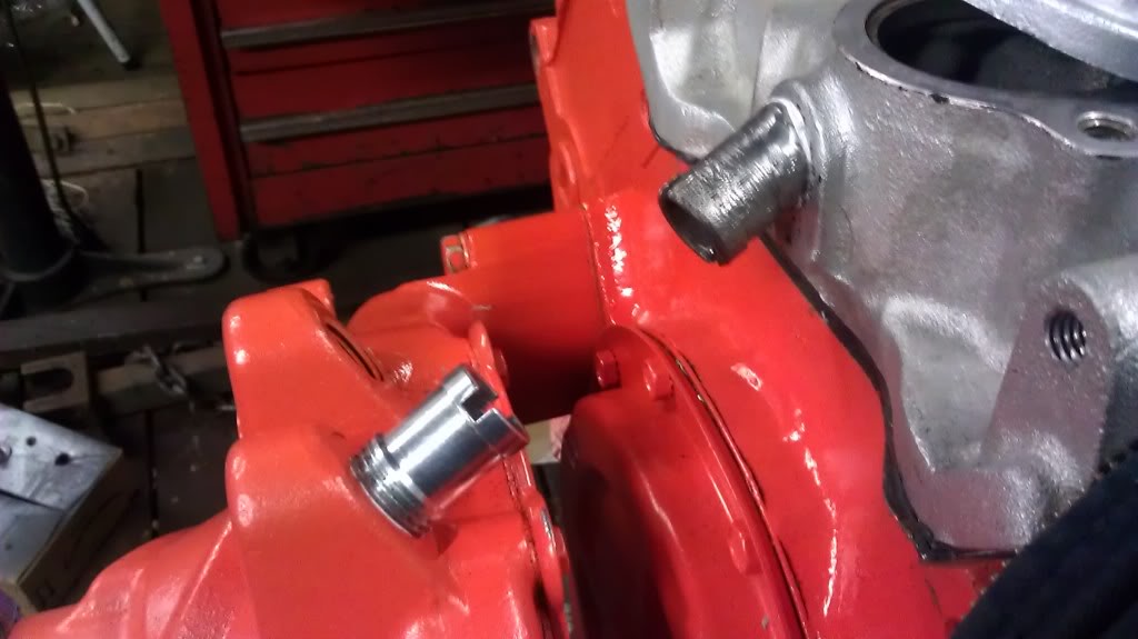

Is there any kind of special tool made for removal and/or installation of the water pump bypass hose fitting in a big block Chevy? This fitting has a slot in the one end, and I'm sure many (if not most)of these fittings have had a large screwdriver used for installation.....but the potential for damage or distortion of the fitting end would seem to make this a less-than-ideal choice.
Trying to remove an old one from a water pump that has been used for years is 'mission impossible' with a big screwdriver. A huge vise-Grip or ChannelLock pliers would undoubtedly work, but would also destroy the fitting. Any suggestions?

heat -- heat -- heat ... last resort, slide a piece of round stock or a socket of the correct size inside the fitting and use a vise grips. Any damage will be covered by hose when installed and not evident. TAZ

A really large screwdriver (like 24" long!) worked perfectly for me....

OK Marlin -- you started it ... I've used a flat end tire tool that I ground down to fit the slots. Used a a large adjustable end wrench to turn tool ... TAZ

If you have an old socket you'd sacrifice, find one that is a close fit around the fitting, cut two slots in it, then place a flat piece of steel in the slots that fits into the notches in the hose fitting.

There were several socket to adjust the tie rod ends on early Chevrolets, probably other cars also. I bought some on e-bay for cheap...Joe

X-2 I use a &quot;Drag Link Adjusting Socket&quot; for heavy duty trucks.

That looks like exactly what I need.....checking into one on eBay right now!
