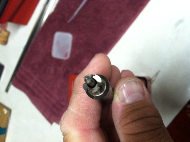

How the heck do you get the metal scrap out of a spot weld bit??? I've gone through 5 and they keep clogging up.

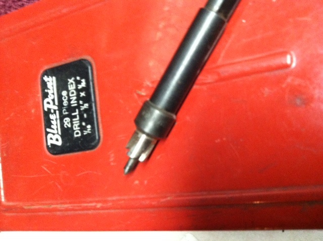

The ones I use have a spring loaded center that hold the top panel while you drill out around the spot weld. It never gets up into the bit..

This one only says ...made in the USA. It's 3/8 in dia. Center punch the center of the spot weld and it cuts thru like butter. Drill speed is king, run it slow. I believe I got it thru Grainger or McMaster Carr. They do come in different diameters, I had one with interchangeable cutters, kind of like a Starrett hole saw set.

Well, the Rotabroach 3/8 lasted for about 15 cuts (using Boelube) before the teeth broke, which isn't so bad.....ordered more bits...

I wish I knew who made mine....Lasted a hell of a lot longer than 15 cuts, gotta be in the 100's. Notice how the cutting edge is more like a end mill not a hole saw.. I'm at work and I'll try to find who we got it from.
