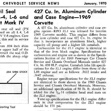

bbdon 08-30-2002 02:40 AM
Re: ZL1 head gasket question?
Here is something that I posted a while back. I think that while the torque specs are the same, they did use longer bolts.

Jeremy 08-30-2002 02:29 PM
Thanks for the help guys, The car will be on hold until we find out for sure.
Jeremy 09-21-2002 09:30 PM
Thanks for the help guys we went with the Fell Pro.
