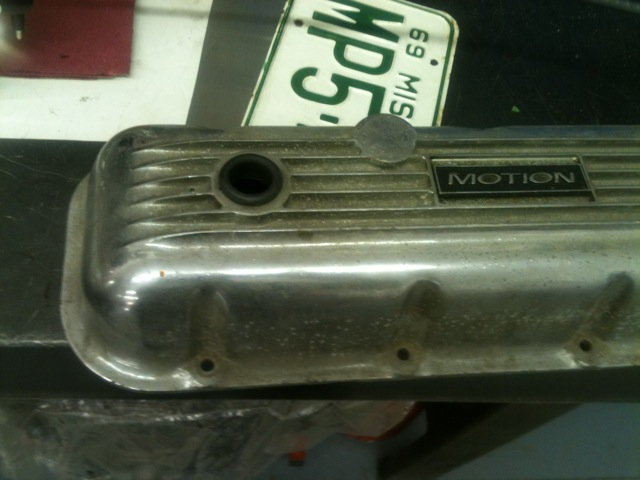

Baldwin Motion valve covers
I believe these are the Real Deal.....embossings all appear correct, stamped "Chevrolet".....can I get some opinions.
Pics...

BACKN 68 03-25-2012 09:40 PM
Re: Baldwin Motion valve covers
The border of the emblem with the "square shoulder", the font of the letters, they appear VERY REAL to me....Nice score!
Where did you find them?
Kent
PxTx 03-25-2012 09:49 PM
Looks real to me too. It seems all of the old authentic, untouched VC I've seen were chromed. These look to be chromed too, right?
Does anyone know if there were any bare alumimum ones sold by Motion wiht the emblems? If so, what was the timeline they fell in?
Postsedan 03-25-2012 09:55 PM
Yep, these are definetly chrome.
Hemicolt 03-25-2012 11:50 PM
I'm not saying this is fact, it's just what I have been told. CP Products and Ansen were the brand names used...yes...no?
Also the old ones have the baffle plate riveted and not screwed in.
The inlay behind the emblem looks to have the "rough" finish. Looks right.
COPO 03-26-2012 12:26 AM
Those covers are a bit newer as the oldest original valve covers would have the Motion emblems that were larger and cut down slightly to fit the inset in the cover. The later covers used a slightly smaller emblem that did not need to be trimmed. CP and Ansen covers were used in addition to the ones with "CHEVROLET 739" cast inside.
PxTx 03-26-2012 01:20 AM
Ansen made the originally. Motion and hundreds of other places sold them in from some time in 1969 through the 1970's. CP later- like 1997 had Ansen do a few more runs (500 qty min) and simply private labled them. The newer ones were made with different tooling from the originals, but it is hard to tell them apart from the outside.
The chrome Motion ones seem to have been less common and unique.
