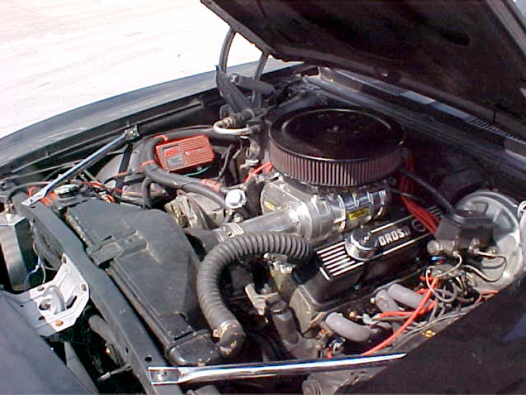

Okay guys....here is one to check out. This auction is coming up with a 1969 SS/RS Camaro ( Look closely at the engine photos )...This may be a Big Block Camaro!

Engine photo shows a small block with a B&M blower.

curved neck radiator?? AC car...was that standard/optional/available with a small block?

....it is my understanding that ONLY big block with A/C cars
..and COPO cars came with that radiator....
....Hmmm?

looks like a big block a/c car ...

doesn't the upper pipe on the A/C box turn toward the air cleaner on a BB?

BB AC goes away from the eng, it's a tight enough fit with that, Small Block AC is turned toward the eng bay. That's a Big Block A/C box as others have stated here.

Better tell GM that they made a mistake on UPC C60, sheet D2! Oh, if small blocks turn toward the engine - then they made another mistake on C60 sheet D1.

Not true...that's a s/b evaporator box. While it seems logical that the POA valve would be on the outside of the box for the larger b/b motor, the General did not do it that way. I have never heard a plausible reason for this.
