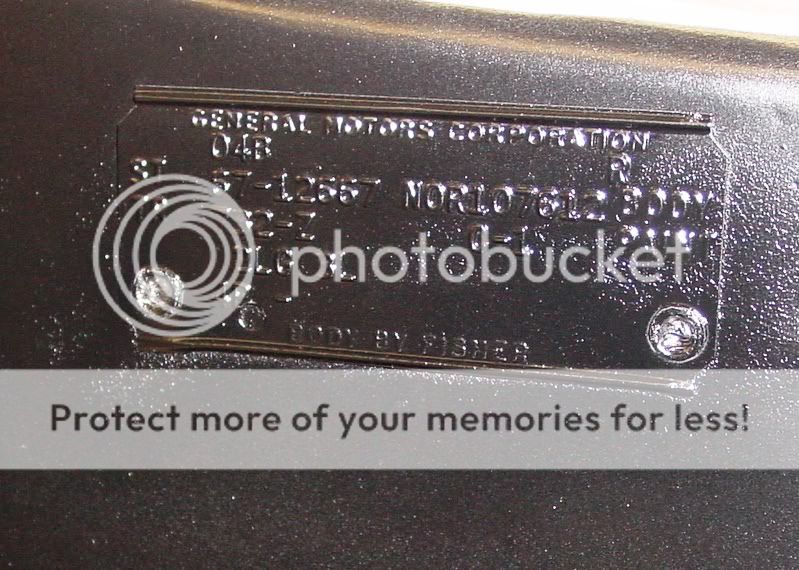

My son-in-law and I just brought home a project 1967 Camaro convertible that I believe is a Pace Car. The trim tag reads 67-12667 with 732-Z trim and C-1 paint, options are 2LG, 3L, 4P Trim tag date is 04B. It's got to be a pace car, doesn't it?

Not necessarily. Lots of white convertibles with blue deluxe interiors were not Pace cars. Its made during the right time that theres the possibility that its a pacecar, but theres more info on that tag that needs to be mentioned. Got a picture of the tag?

look for a code on the trim tag - L181A
resto4u 12-18-2009 06:04 AM
Re: 1967 Pace Car?
O-1 pace cars have clear coat and were festival cars. C-1 cars are non track festival cars.
Kurt S 12-18-2009 08:41 AM
Re: 1967 Pace Car?
The O-1 cars were not clear coated. Chevrolet did not have the facilities to do that.
It's likely to be a pacer with those colors. The VIN and tag will help tell for sure.
bergy 12-18-2009 04:35 PM
Re: 1967 Pace Car?
Thanks for the feedback - I got a PM re what to look for to assure that it's a "blue nose" Pace Car versus a "black nose" RS/SS. It does have the dash after the 4P - so apparently a Pace Car. Also has a perfect 3/16" hole in the trim tag right by the "P" in the "4P" area - don't know what that's all about. The guy that I bought it from had no idea - he was making it into a resto mod - putting a big block into it. We'll probably continue with his plan.

Finally got a chance to get back over to the body shop to get a pic of the trim tag
http://i375.photobucket.com/albums/o...CarTrimtag.jpg

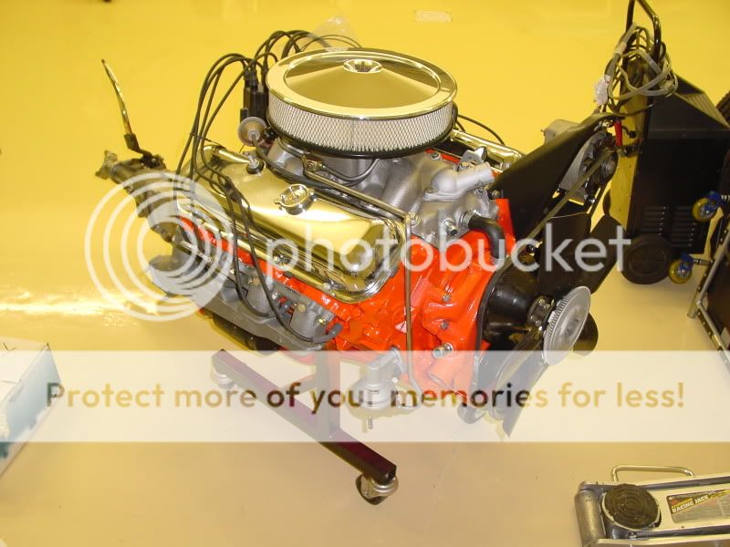

The resto is well underway. I do have a question for you gurus though. The motor/trans that I'm using can be seen below - question - is the comp plus shifter going to interfere with an original '67 Camaro console?
Also - better chack to see if any of these parts "belong" in any member's cars before I install them in this car. #272 block (2 bolt "JU" with partial viv #161 at the filter bowl). Trans #010 with vin 6Z117134, build date P1130.
http://i375.photobucket.com/albums/o...0/DSC00370.jpg
http://i375.photobucket.com/albums/o...0/DSC00368.jpg
budnate 03-30-2010 11:12 PM
Re: 1967 Pace Car?
nope thats the one, only deal is and I dont see it on yours the bottom bolt on some let it rotate front to back if that makes sense, its nice as it lets you center the shifter in the slider on the console as sometimes when getting 1st or 3rd you can bottom out in the slider and start to chip the chrome on the shifter and the console insert and also helps to get it where it fits you...just right for that 1-2 grab https://www.yenko.net/ubbthreads/imag...ins/3gears.gif

I have a real '69 shifter handle that has been drilled for a newer comp plus shifter. maybe I should put that on?
budnate 03-31-2010 05:25 AM
Re: 1967 Pace Car?
sorry but Jason is not right on this one, there the same shifter 67,8,9. they rub from not being centered in the hole like I said, '67 consoles are unique and tight, if your tight on the left, its because the trans is left on the mounts, loosen up the trans push it hard to the pass side and have the other guy tighten it down, if thats not enough do the same to the cross member. thats what makes '67s so cool when you get it right and the slider glides back and forth as you row through the gears https://www.yenko.net/ubbthreads/imag...lins/beers.gif
budnate 03-31-2010 07:25 AM
Re: 1967 Pace Car?
1 Attachment(s)
here is a old pic a Hurst shifter in neutral in a '67 console and it did not rub. https://www.yenko.net/ubbthreads/imag...lins/beers.gif
