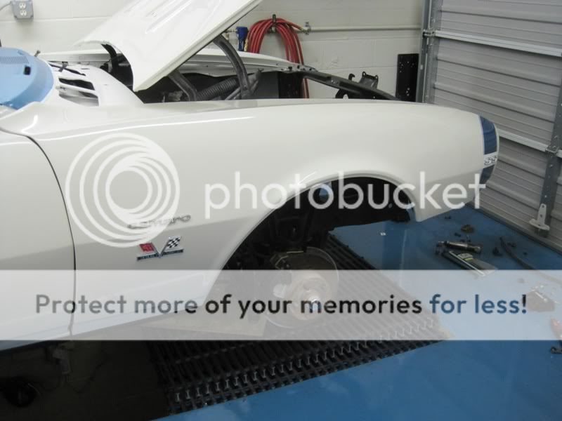

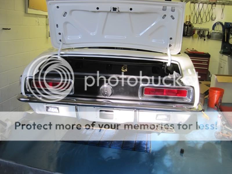

Here are a couple of pics that I took today of my winter project.
http://i375.photobucket.com/albums/o...0/IMG_0121.jpg
http://i375.photobucket.com/albums/o...0/IMG_0122.jpg
Also, does anyone have info/techniques on getting old horns to work? This discussion may belong in a different catagory - but they are the horns to this car.
