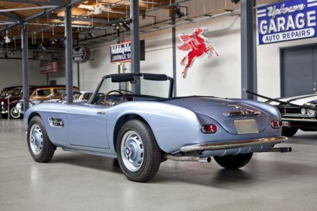

Indeed, the frame would be a modified Cobra frame. Dimensions are remarkably similar. But nothing else is. Torsion bar suspension (familiar with that from the Mopar genre). Hmmmm..... is there a BMW thread section? Might have to "member ride" it! I'll already have another one going in the Mopar section shortly

Have always loved the 507. It was more expensive new than the Mercedes Gullwing cars (but has not kept up since then price wise). Did not sell that well, and almost bankrupted BMW.

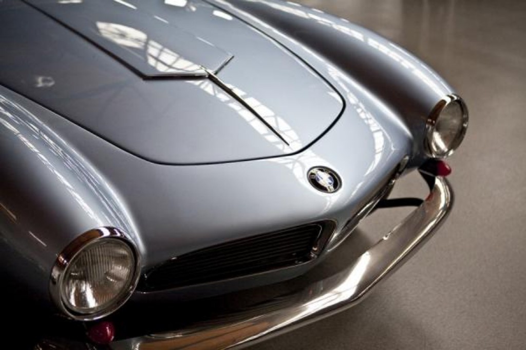

I have always thought the 507 was pure sex - the body lines, the curves and the fact that they were completely hand formed and no two were exactly alike.
Would love to see one re-created but might be more fun with a 12.

Seems like you could not fit a V8 under that hood nor could you get enough tire under it (without flares) to handle the V8 power.

It came from the factory with a 3.2 liter V8
