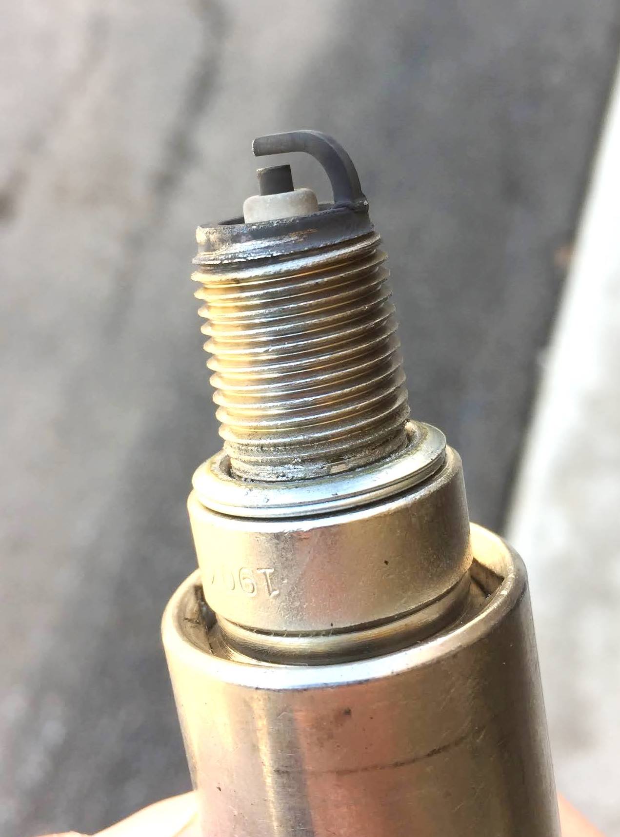

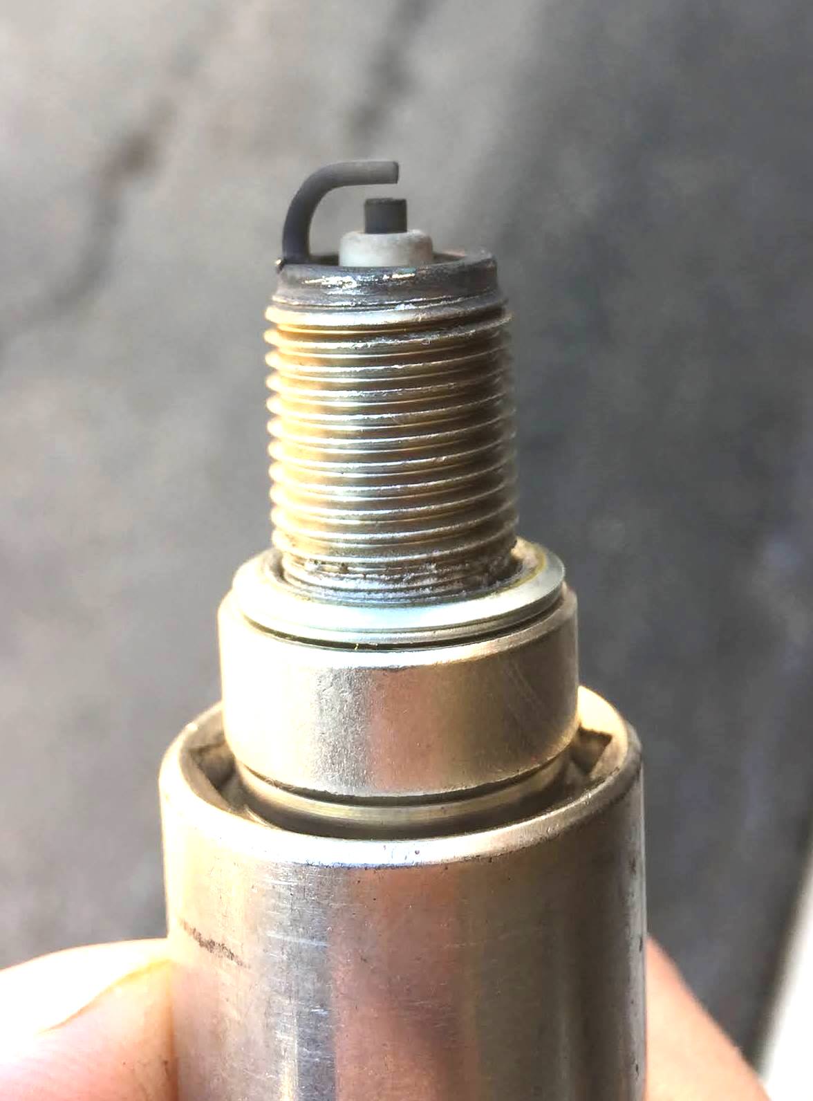

I pulled a plug out to check how things are burning. Looks very nice. The color change point on the electrode is right at the 90 degree bend point from light grey to dark grey. I am quite pleased with that. (Running 1/4 tank of 100 octane leaded avgas and 3/4 tank of 93 unleaded super.)

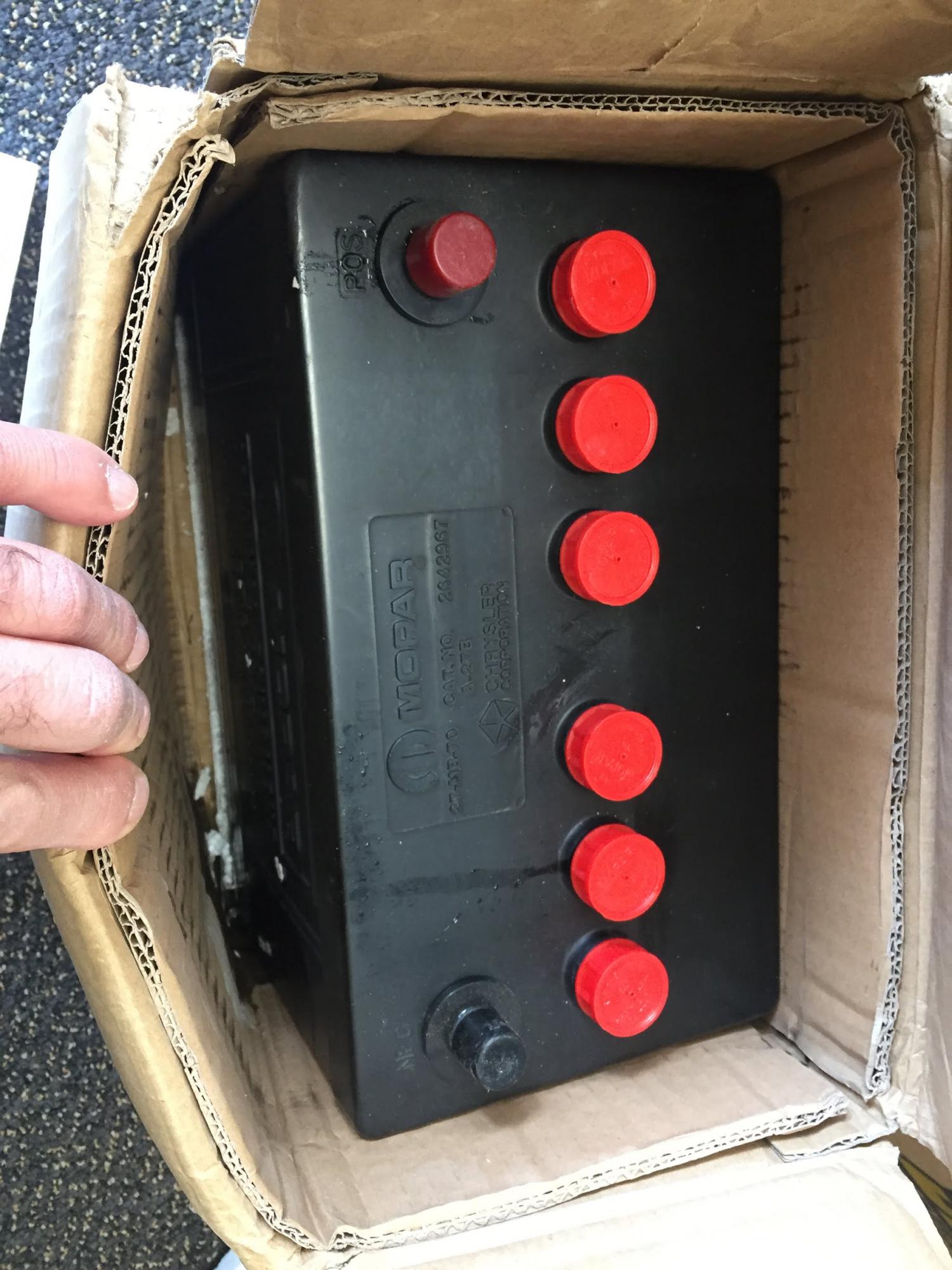

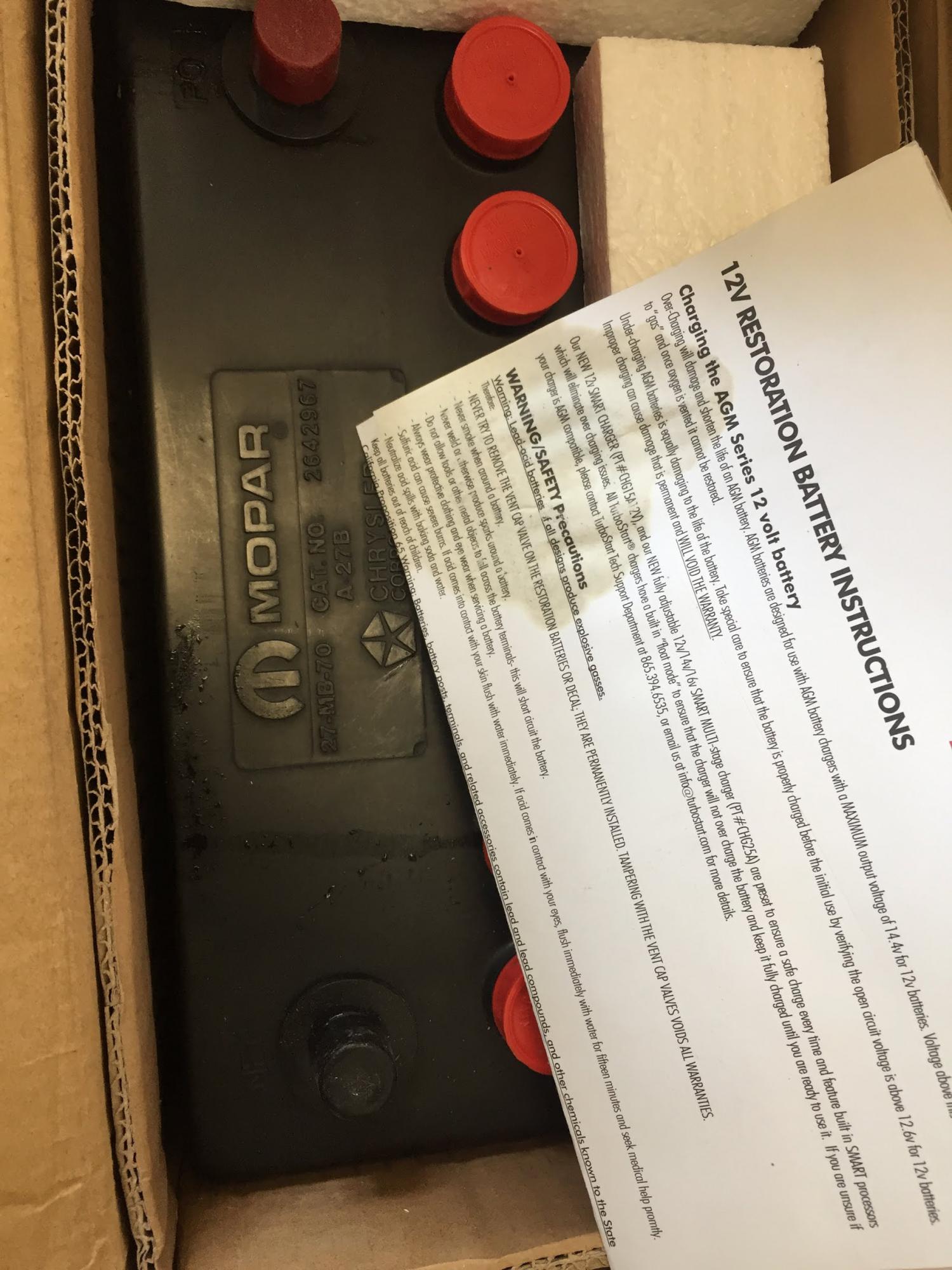

And Fedex Ground strikes again.
I found the only remaining TurboStart reproduction Mopar group 27 size AGM battery left in the United States. (No other sizes available either - this was an orphan sitting on a shelf).
TurboStart stopped making them a over a year and half ago and keeps delaying any new production til who knows when (maybe later this summer, last I heard from them).
Shipped from Jegs on Tuesday for a Thursday delivery via Fedex Ground...Shows up Monday busted and leaking acid from the bottom of the box.
Jegs immediately refunded my money. Fedex doesn't give a crap and won't pick it up because it's toxic waste (LOL). Jegs told me to dumpster it.
